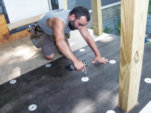

A roofer screws down tapered foam insulation from a "roof kit" while preparing the deck for a membrane roof. Sloped roof kits don't cost much more than ordinary insulation, so they're a cost-effective way to achieve the appropriate slope.
Doug Horgan/BOWA

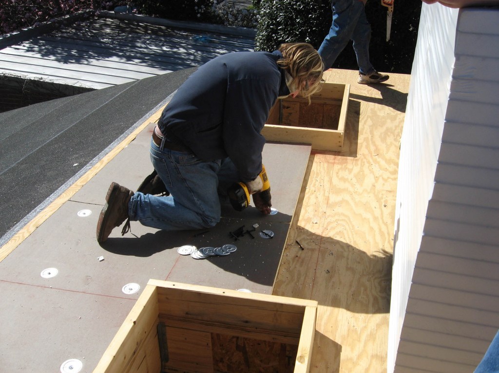

In a fully adhered system, the membrane is installed over a fiberboard that’s compatible with EPDM adhesive. The following shows the basic steps for installing this material. Some EPDM manufacturers have a network of certified installers.
Installing Fully Adhered EPDM
The EPDM installation starts with a 1⁄2-inch-thick fiberboard underlayment engineered to bond with the roofing adhesive. It scores and cuts like cement board and is fastened in place with galvanized screws and washers.
The EPDM installation started with a 1/2-inch-thick fiberboard underlayment engineered to bond with the roofing adhesive. It scores and cuts like cement board and is fastened in place with galvanized screws and washers.

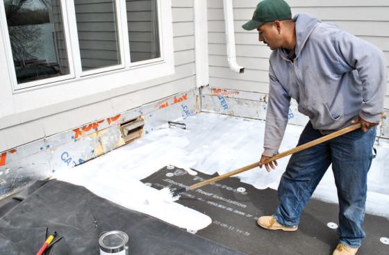

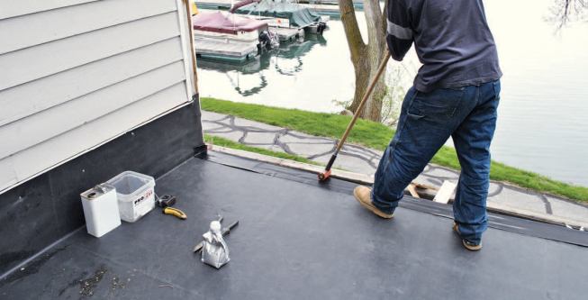

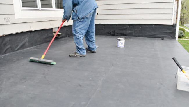

After sweeping the surface clean, use rollers to spread the contact-type adhesive on both the membrane and the deck.

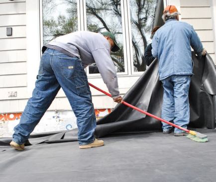

Spread the rough-sized membrane sheet out on the deck, smooth out the wrinkles, and get it into final position. Then roll the sheet back onto itself halfway.
After sweeping the surface clean, the crew applies latex bonding adhesive.

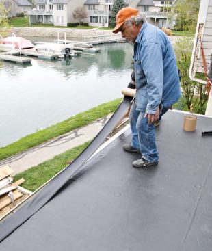

Once the adhesive is tacky (about 5 minutes), carefully roll the membrane back into place and brush the surface with a stiff deck broom. This presses out air bubbles and creates a strong adhesive bond. Repeat the process for the other half of the sheet.
As the cement sets, a worker uses a broom to press out air bubbles and create a strong bond.
After the entire sheet is adhered, brooming continues until all the bubbles are worked out at the upper edge.

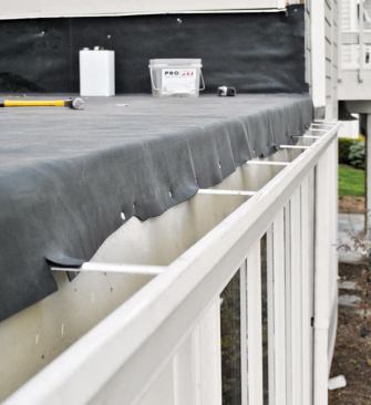

Pull the EPDM tight over the roof edge and tack it in place (A), leaving it long enough to ensure that water flows into — rather than behind — the gutter. Install gutter apron on the roof edge (B). Apply glue to the apron, followed by seam tape (C). Seat the tape with a rubber roller (D).
The roofers pull the EPDM tight and tack it in place, leaving it long enough to ensure that water flows into — rather than behind — the gutter.

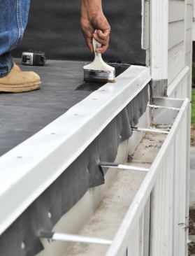

The roof edge is protected with a gutter apron. Glue is applied to the apron.

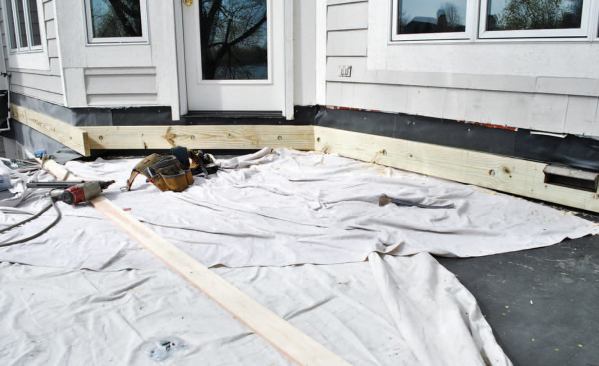

Roof to Wood
  • For a wood-sided wall, run the EPDM behind the bottom course of siding.
  • If the EPDM will be covered with a rooftop deck, the deck ledger can be used to secure the top of the membrane, then the ledger covered with flexible flashing that extends up under the siding.
A pressure-treated deck ledger supports the inboard end of the new joists.

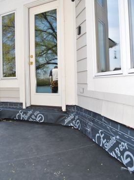

The deck ledger is flashed with Ice & Water Shield.

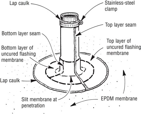

At outside corners, slit the membrane and apply a two-layer patch of uncured flashing membrane. Inside corners can be either slit and patched like an outside corner, or folded and secured with a termination bar.
Waterproofing Penetrations Through EPDM
Penetrations can be sealed with uncured EPDM or with PVC donuts made for this purpose.
Uncured EPDM
Narrow rolls of uncured EPDM are available for patching and flashing applications. Uncured EPDM has no memory, so when you stretch and glue it around a vent pipe it forms itself to the shape of the pipe.

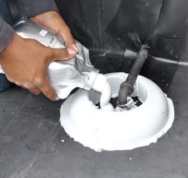

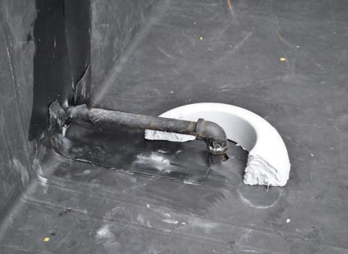

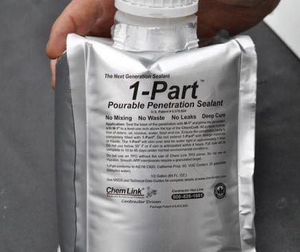

PVC Donuts
Cut the donut in half to fit it around the pipe (A), then glue it to the roof with a pourable sealant (B). Use the rest of the sealant to fill the center (C). The cured sealant (D) stays flexible over time so it can adapt to movement in the roof without losing its seal.
The author seals pipe penetrations with PVC donuts. First the donut is cut in half to fit around the pipe.

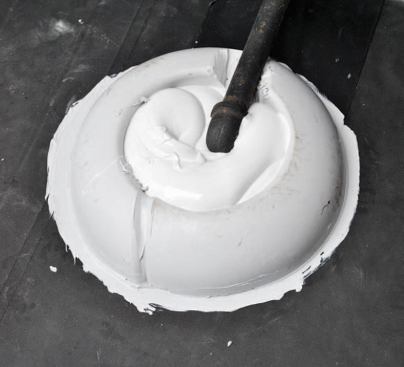

Pourable sealant
Pourable sealant
Sealant is also used to fill the center.
The cured sealant stays flexible over time so it can adapt to movement in the roof without losing its seal.
Patching EPDM
Patches require two layers of flashing membrane — a smaller first layer and a wider top layer that completely covers the bottom layer. Patches and flashing are glued with splicing adhesive.

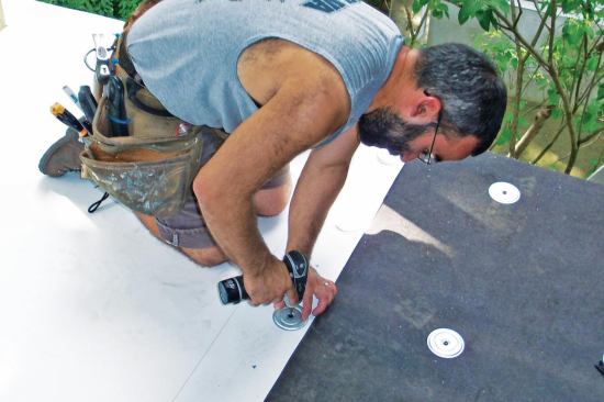

To protect against fastener show-through, the author added a layer of wood-fiber recover board, fastened to the structural deck with the same reinforced galvanized screw plates and 1 5/8-inch screws used to secure the TPO membrane.
Emanuel Silva

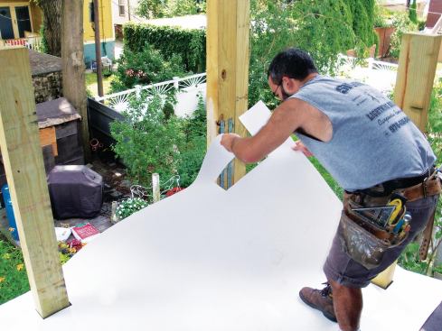

Cutouts in the membrane allowed it to slip over the tops of the posts, minimizing seams; an open cutout at the outside corner column accommodates the membrane turn-down along both edges.
Emanuel Silva

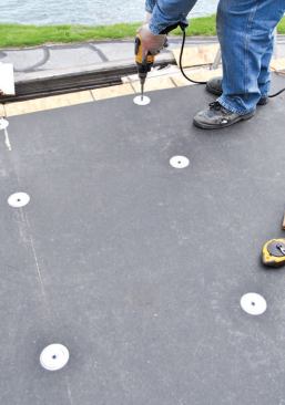

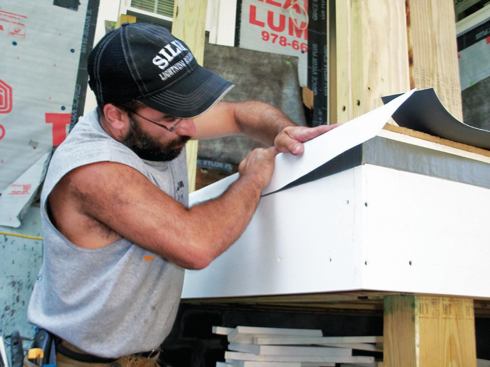

The upper edge of the first sheet of membrane is screwed to the deck at 12-inch intervals. A preprinted line 4 inches from the edge marks the correct overlap for the next sheet.
Emanuel Silva

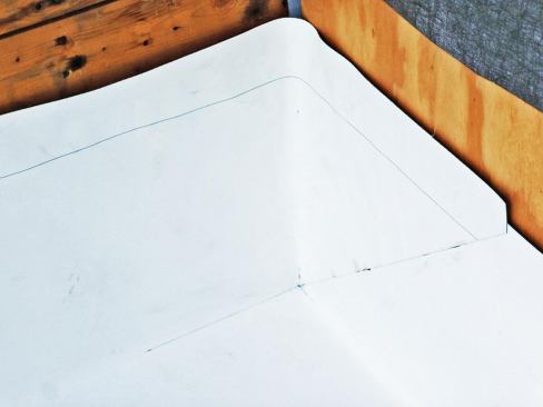

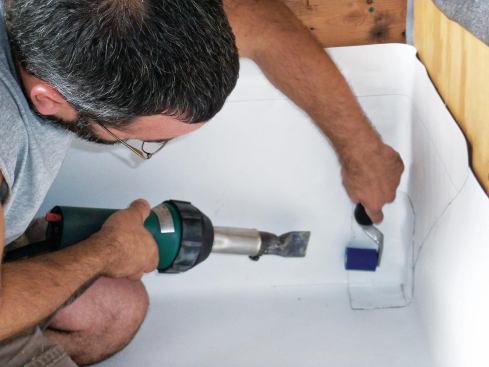

Seams at inside corners leave a potential pinhole leak where the deck and walls intersect.

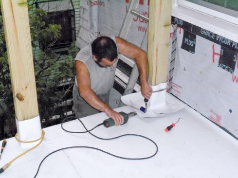

A prefabricated corner piece is heat-welded to all three surfaces.

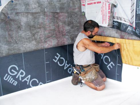

Peel-and-stick membrane flashing adhered to the sheathing serves as a counterflashing. It will later be covered with housewrap.

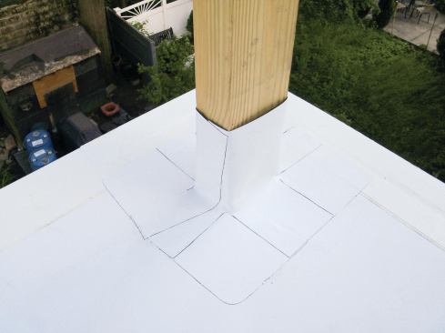

Square-sectioned flashing boots are temporarily secured with provided band clamps before being welded to the deck with the heat gun and roller.
Emanuel Silva
The orange-handled tool next to the post is a pointed probe that’s run carefully along welded seams to pinpoint any missed areas. The boot’s overlapping split side — which allows it to be wrapped around a continuous column — is welded closed. The open top of the finished boot will be covered with flexible flashing.

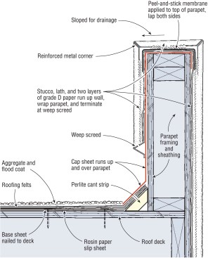

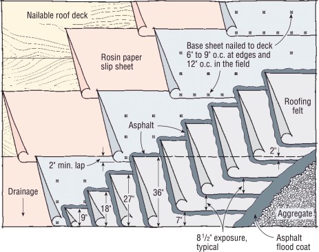

Built-Up Roof Layout
Built-up roofs may have three, four, or five plies. The ply number denotes how many layers are on the roof at any given point. A three-ply roof should last about 15 years, with each additional layer adding another five years.
  • The roof is covered with a sheet of red rosin paper, which acts as a slip sheet.
  • The rosin paper is topped with a base sheet consisting of an asphalt-coated, fiberglass-reinforced mat. On wood sheathing it’s fastened using 6d nails with 1-inch caps spaced 6-9 inches on center at the edges and 12 inches in the field. The base sheet runs to the top of the cant strip and is cut to fit around roof penetrations.
  • The first coat of asphalt goes on the base sheet, followed by a layer of felt, which must go on while the asphalt is hot. Successive layers are then applied.

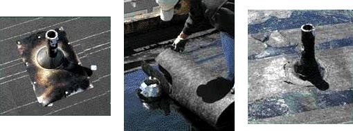

Flashing Around Roof Penetrations
• Flashings are bedded in plastic roof cement over the base sheet, nailed in place, and primed to make the hot asphalt stick better. • The roofing felt and asphalt are laid over the flashings.• The flashing is then sealed with roofing cement and coated with an aluminum paint to protect it from UV light.

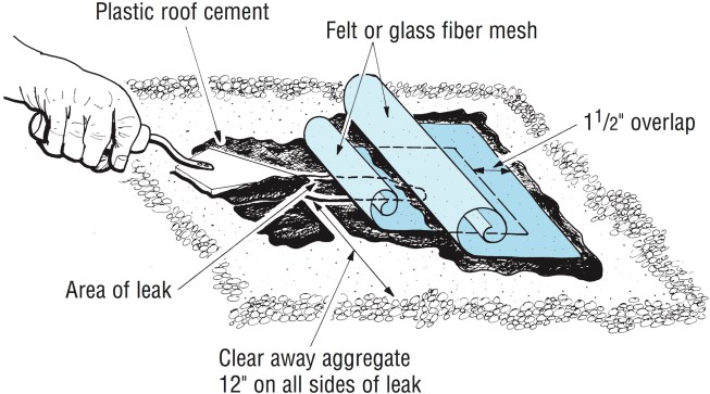

Patching Built-Up Roofs
The source of a leak in a BUR can be hard to track because water can travel through the plies and emerge just about anywhere.
Troubleshooting Built-Up Roofing
  • Blistering (left) indicates that the built-up roofing wasn’t installed properly. Dirt or moisture may have gotten between the plies during installation, fasteners may not have been driven tightly enough, or the contractor may have used incompatible materials. Isolated blisters can be fixed following the patching procedure below.
  • Alligatoring (center) is caused by lack of gravel in the flood coat. The surface of the roof has dried out and is starting to deteriorate. It means that the surface of the roof has dehydrated and begun to come apart. If the damage is minor, and if the roofing felts haven’t yet hardened, you may be able to restore them with a mineral rubber resurfacer and sealant. If the felts have dried out, apply a primer first. Whatever the scope of the repair, remove all gravel first.
  • Ponding (right) indicates a lack of positive drainage — caused either by poor roof design, faulty installation, or settlement of the roof structure. Unfortunately, there’s not much you can do about it short of a radical restructuring of the roof frame.

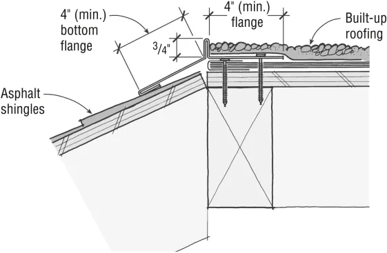

Slope Transitions
A flat built-up roof that meets a sloped roof must have a gravel stop to prevent the asphalt flood coat and gravel from migrating down the sloped roof.
Making Small Repairs
Small BUR repairs can be made with a felt or a modified bitumen patch.
Felt Patch
1. Prep the Area
Clear away the aggregate in the top or “flood” coat with the claw of a hammer or, for larger areas, use a chipping bar (be careful not to damage the existing BUR membrane below the coatings). Smaller stones can be scrubbed away with a wire brush.
2. Apply the Patch
  • Use a minimum of two layers of felt or glass fiber mesh to repair BUR. The bottom layer should be 1 1/2 in. smaller around the edges than the top layer, so that each can bond separately to the existing membrane.
  • Apply the patch with a thin coat of plastic roofing cement. Apply plastic roofing cement carefully: too much will weaken the bond between the existing BUR and the new patch.
