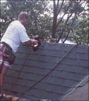

To create this gable vent, I first side the wall to a course about 4 feet down from the gable peak. Then I take a 1×10 or 1×12, and cut it into a bow about 3 feet wide with an oblong hole in the center, leaving 1 inch to 1 1/2 inches of material around the perimeter, as shown in Figure 3. After covering one side of this bow with insect screen, I mount it to the wall about 1 inch up from the bottom of the next shingle course. About 8 inches above the bow, I cut a 12-inch hole through the sidewall sheathing.
Next, I cut one or two tapered 2x “rafters” with a base that matches the width of the bow. The rafter supports the middle of a 1/4- to 3/8-inch plywood cover that forms the shape and structure of an eyebrow. This custom gable vent provides a right-angle vent pathway for air that proves reasonably weather resistant. Still, such a high gable vent needs to be coupled with soffit vents to provide effective attic ventilation.
Figure 3. To create this gable vent, Guertin begins by cutting a bow like this from a 3-foot-long 1×10 or 1×12. About 8 inches above the bow, the author cuts a 12-inch hole through the sidewall sheathing, then frames an eyebrow with triangular 2x rafter blocks. This structure will be wrapped with 3/8-inch plywood and shingled over, as seen in the photo above.
