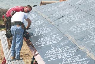

On this waterfront roof, the builder covered the entire roof with self-adhering membrane, eliminating the use of standard #30 felt underlayment. With a self-adhering membrane and reduced course exposure, cedar shingles may be installed on roof slopes as shallow as 3/12.
