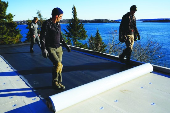

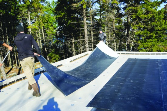

The crew rolls out the EPDM and gives it a half hour to relax.

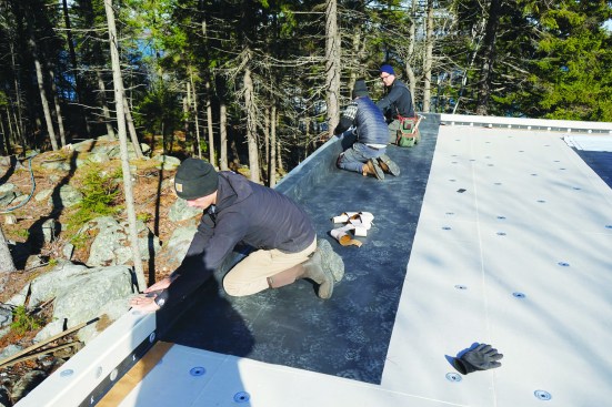

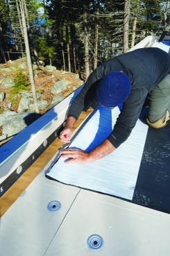

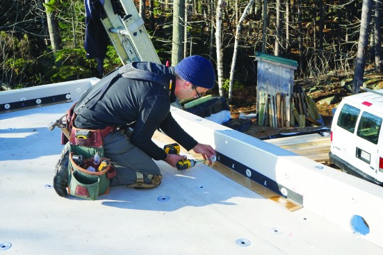

We started the EPDM process by installing a 6-inch reinforced perimeter strip (RPS) from Firestone. It is meant to lessen the fatigue the EPDM will experience at the roof-to-parapet transition. If we were to adhere the membrane directly to the cover board at this horizontal inside corner, it would likely debond over time. We fastened the 3-inch parapet leg of RPS 12 inches on-center with 2-inch metal plates and 2 1/2-inch screws. The 3-inch half on the roof deck had a pressure-sensitive tape covered by selvage paper that we removed just before installing the EPDM.
The reinforced perimeter strip (RPS) is cut to length.
Then it is screwed to the side of the parapet.

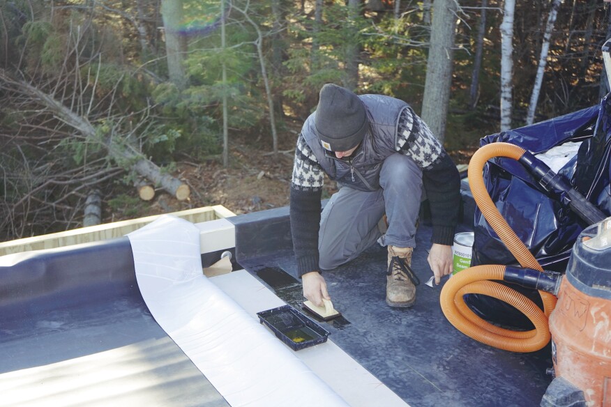

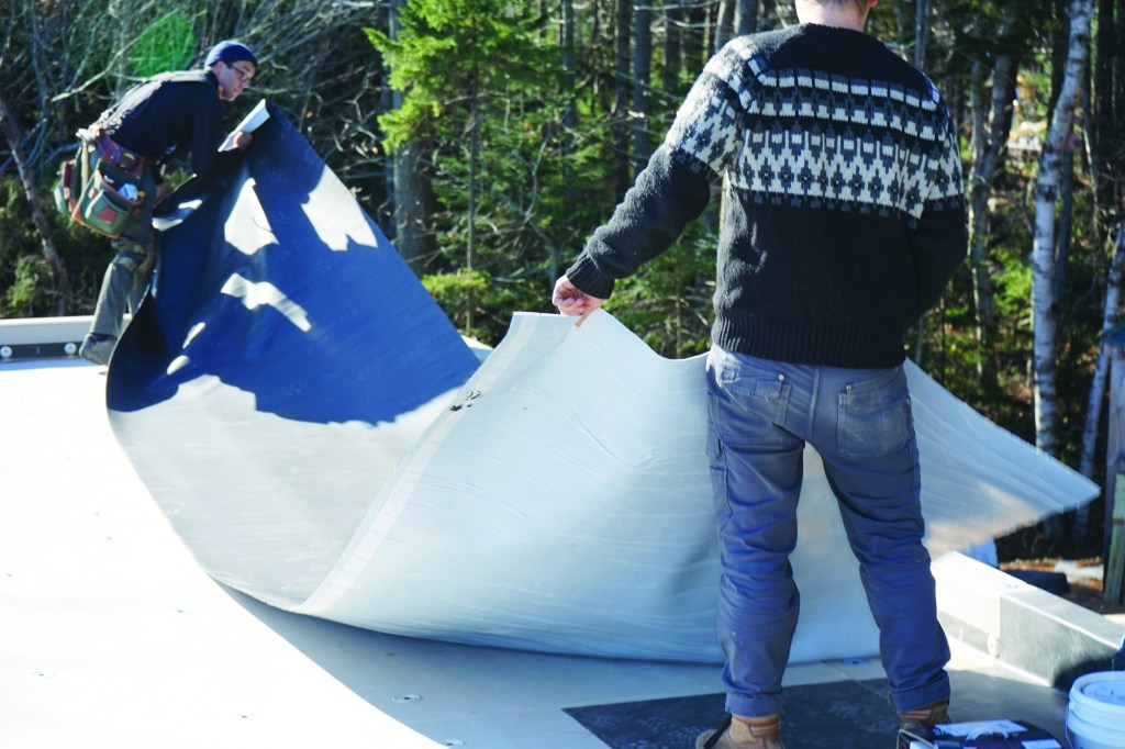

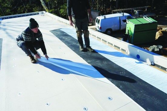

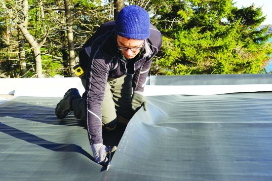

While the last of the RPS was being installed, we rolled out and cut three lengths of EPDM about 2 feet longer than needed. A pair of heavy-duty scissors works well for almost all of the cutting tasks associated with EPDM. After unrolling, it needs to relax for about 30 minutes. We assessed our game plan, made sure we had the necessary materials on hand, and prepped for the first pieces. I wanted to start at the downhill side to properly shingle lap the subsequent runs. This also meant we had to do the more complicated ridge, valley, and scupper portion first. I didn’t know if the EPDM would conform well enough to the undulating surface to avoid wrinkles or stretching, but after watching it relax, I realized it wouldn’t be a problem. Even so, we decided to cut the first sheet in half lengthwise, roughly at the ridge, to simplify things.
The crew slits the backing plastic on the EPDM.
Then the surface of the reinforced perimeter strip (RPS) is primed.

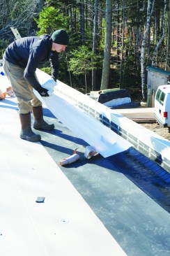

The backing plastic is pulled off the EPDM where it lies on the substrate.
Next, they pull the backing paper off the RPS.
The backing plastic is pulled off the other edge of the membrane.

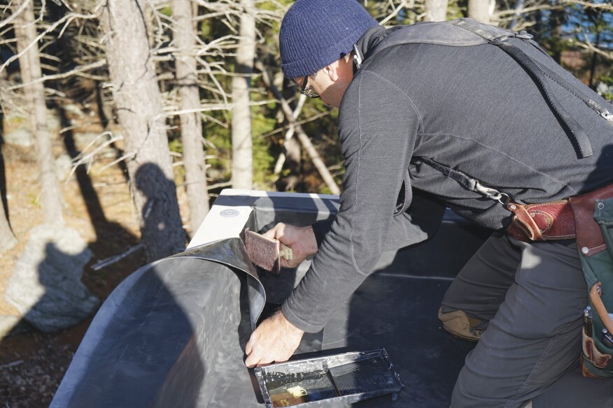

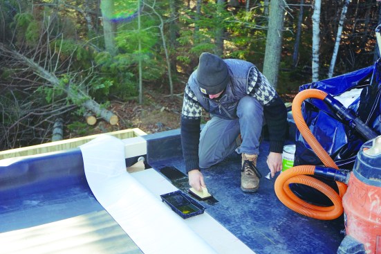

To transition the EPDM over the RPS, it is helpful to carefully slice the backing sheet so you don’t have to remove all of it and risk the sheet adhering to itself or slipping out of position. (Just like traditional contact adhesive, the SA version is stuck if it goes sticky to sticky.) I cut an extra “ZipperKnife” from a ZipWall dust containment kit in half. It works perfectly for this task. We positioned the EPDM where it needed to be, folded it back to just before the RPS at both the long edge and the 10-foot edge, and used the modified Zipper­Knife to slice the backer at the folds. This allowed us to adhere the bulk of the sheet and start working the tricky transition areas.

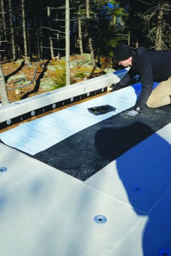

That edge is carefully rolled up onto and over the parapet.

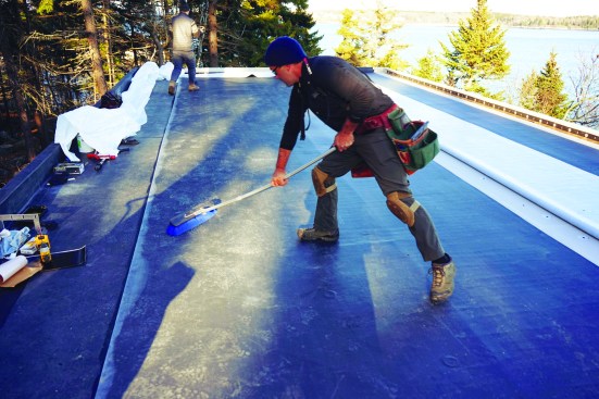

While two of us started the transition, another crew member used a push broom to work any air bubbles out and to apply pressure for a good bond. It is not recommended to use a weighted roller if using PIR cover board. We removed the remaining backing sheet, as well as the selvage paper from the RPS; it is easiest to keep the EPDM folded back onto itself and push it over the RPS and tight into the inside corner. We used our hands to smooth it up and over the wall, and let the remainder lie loose over the outside of the wall as we shifted our focus to the vertical inside parapet corner.

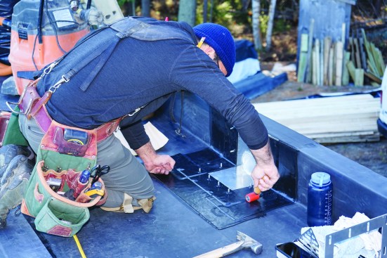

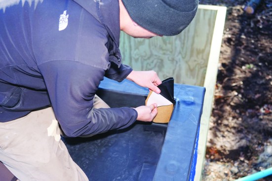

Detailing the parapet corners is a tricky process best learned from Firestone’s YouTube videos. Here, the author cleaned and primed the EPDM before executing his corner fold.
Crew member Zack Payne applied flexible uncured EPDM flashing over a corner joint.
Installation at the vertical inside corner of the parapet is the trickiest part. I won’t try to muddle through an explanation; Fire­stone’s videos do an excellent job of illustrating this detail. It is key to have splice adhesive on hand to bond the non-adhesive sides of EPDM together. Earlier, while the EPDM was relaxing, we had cut corner patches from 9-inch GenFlex Peel & Stick EPDM Flashing (uncured EPDM). This stretchy, flexible patch, applied over a quick scrub of primer, finishes off the corner detail. We did the other half of this run the same way, but with a little more confidence at the vertical inside corner.

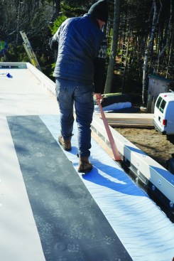

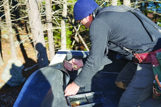

At the ridge splice, we used primer to clean the talc off the face, waited for it to be dry to the touch (about 5 minutes), and then bonded the two sheets together. This is another area where the SA version shines. All it takes is a quick scrub with primer to bond the adhesive side to the face of the membrane; no waiting for primer then splice adhesive to dry (especially handy on a 35°F day). Ensure a high-quality bond of all spliced joints and flashing tape with a good amount of pressure from a small silicone roller.
Crew member Finn Bradenday primed the EPDM at the lap joint.

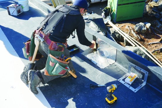

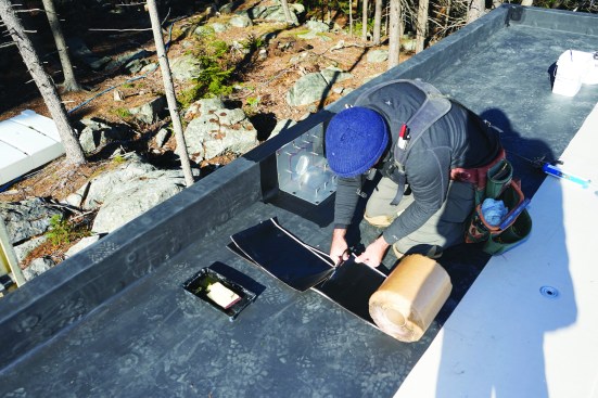

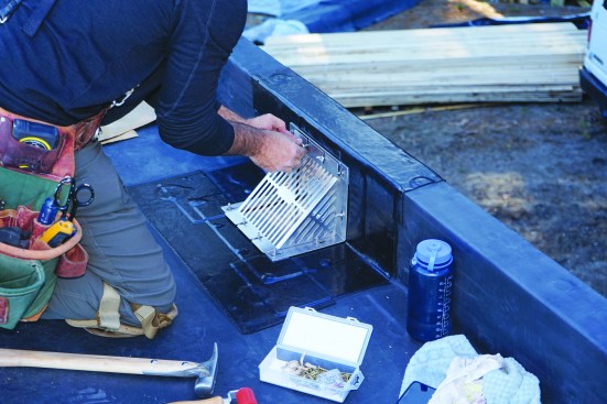

Detailing the Scuppers

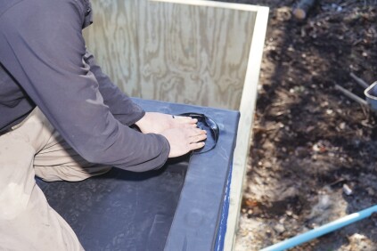

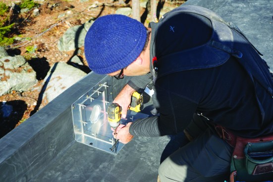

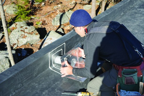

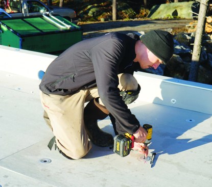

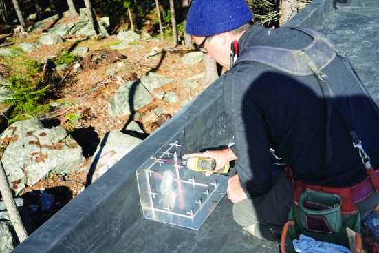

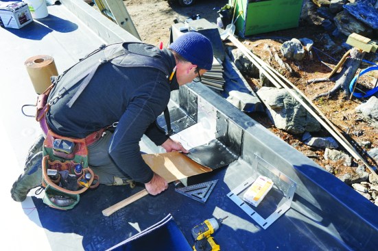

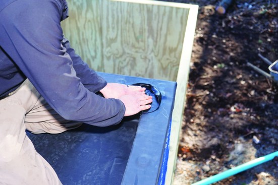

I purchased the aluminum through-wall scuppers from OMG Roofing Products. I began by cutting a hole through the EPDM slightly smaller than the 4-inch drainpipe, hoping that if it ever leaked, maybe this would provide some form of backup to keep water out of the PIR layers. Prior to pushing the drainpipe through, I applied beads of GenFlex EPDM Waterstop, again as a backup.
It is a tenacious butyl-blend mastic that works well when using a compression-type seal. I fastened the scupper with appropriate-length screws and then cut four pieces of EPDM flashing tape. I dry fit the 9-inch flashing tape by positioning it over the threaded studs and tapping and perforating it with my hammer, then I pushed it over the studs and traced its outer edge with scissors. The trace lines helped prevent overshooting with the primer and kept things nice and tidy. After the primer dried, we installed the two sides, followed by the top, and then finally, we adhered the roof deck piece to help shingle lap at least some of the tape joints. We then rolled the flashing tape to ensure a good bond. The compression ring was installed with locking hex nuts to “finger tight,” and the grate with wing nuts, again with moderate tightness.
The crew pulled the backing plastic away from a full-width section of EPDM.

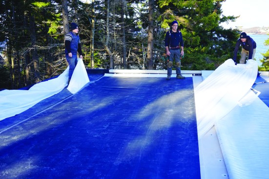

The third and final run of EPDM installed faster as we got more proficient. It helped to have three people installing the long runs. Once a sheet was positioned, we folded 3 or 4 feet onto itself, started removing each half of backing, and then rolled this 3 or 4 feet of membrane back to tack the adhesive side. At this point, two people can start pulling each half of the backing sheet out at a 45-degree angle while a third walks on the membrane to keep an eye on things. There is a little bit of adjustability if it starts to slide off track (not much, though—proper positioning before pulling the backing sheet is key). Again, after the backing is removed, apply pressure with a push broom at a 45-degree angle, and roll the 3- or 4-inch overlaps with a small silicone roller to ensure a good bond. It was tedious using such a small roller for the overlaps, but it was part of the manufacturer’s installation procedure.
The author used a push broom to press the roofing into place, securing a good bond with the substrate.

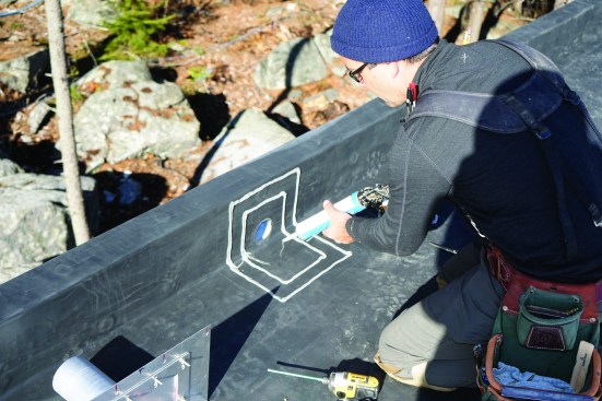

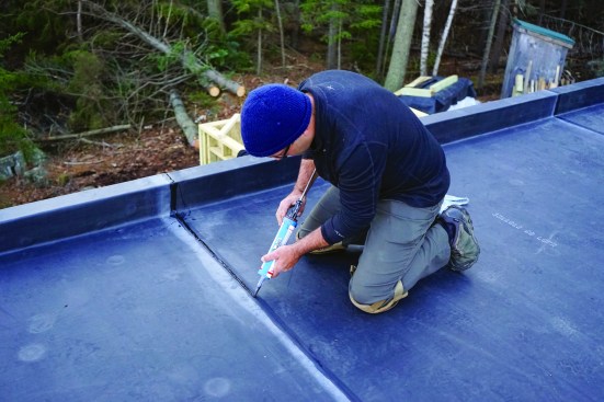

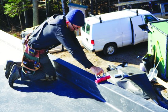

Once all the EPDM was down, the author sealed every seam with lap caulk.
The final step is to apply lap caulk (Firestone Full Force Sealant) at all the field overlap joints (30), flashing tape edges, and inside corner edges. A quick scrub with primer to either side of the overlaps and edges provides a clean bond for generous 3/8-inch-wide-by-1/8-inch-tall beads. Lap caulk should be inspected every four to five years as part of a maintenance schedule, and touched up as needed.
