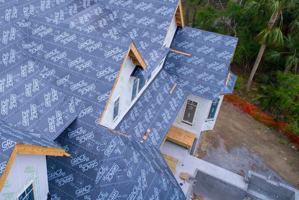

  4. Underlayment Unease. Wulf identifies characteristics contractors should look for in underlayment: 1) The product should stick to the substrate – “Nothing fancy, it’s just common sense.” 2) The membrane should stick to itself on the overlap. 3) The membrane self-seals around fasteners. Otherwise, “… you just punched a bunch of holes in your roof,” he warns.
  5. Intersection Indigestion. Make sure there are no membrane cuts where wall meets roof. Always leave a generous lap of at least 4 to 5 inches to help seal-off moisture.
