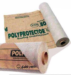

Polyprotector UDL
• Polyprotector UDL is a polyolefin-based, multilaminate underlayment sold in 39 3/8-inch-wide rolls (the shortest in our survey), each of which provides 948 square feet of net coverage. The distinctive light-adobe-colored woven top layer is printed with lap lines and fastener locations; it provides good traction, and shows and holds a chalk line well. On the underside, a fuzzy white spunbonded poly layer gives the roof wrap a grip on the roughness of the decking and just a little cushion, making this underlayment very comfortable to walk on. Polyprotector UDL is supposed to hold up for 180 days when left exposed, but it didn't in our mockup. Our sample curled at the laps in the first few weeks, exposing the fuzzy underside, which is not UV-resistant. The fuzz held water and carried it up the underside of the roof wrap a bit, and eventually the fuzz at the laps disintegrated in the sun.
