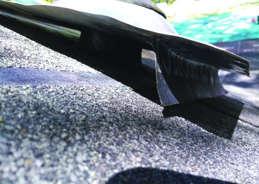

Nearly every house has a plumbing vent pipe through the roof, and most of these pipes are sealed with a boot flashing. On boot flashings, there are just a couple of inches around the metal pan bell to blend with the roof shingles to resist water intrusion. Like most builders, I used to apply plastic roof cement or another sealant to block water from being blown under the bottom edge or in along the side laps of the flashing.

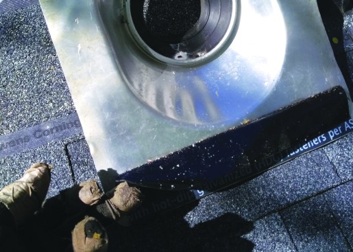

Apply flashing tape to the underside of the lower edge of the flashing, adhering half the strip to the metal.

Slip the boot over the vent pipe and press the remaining flap of tape onto the shingles.

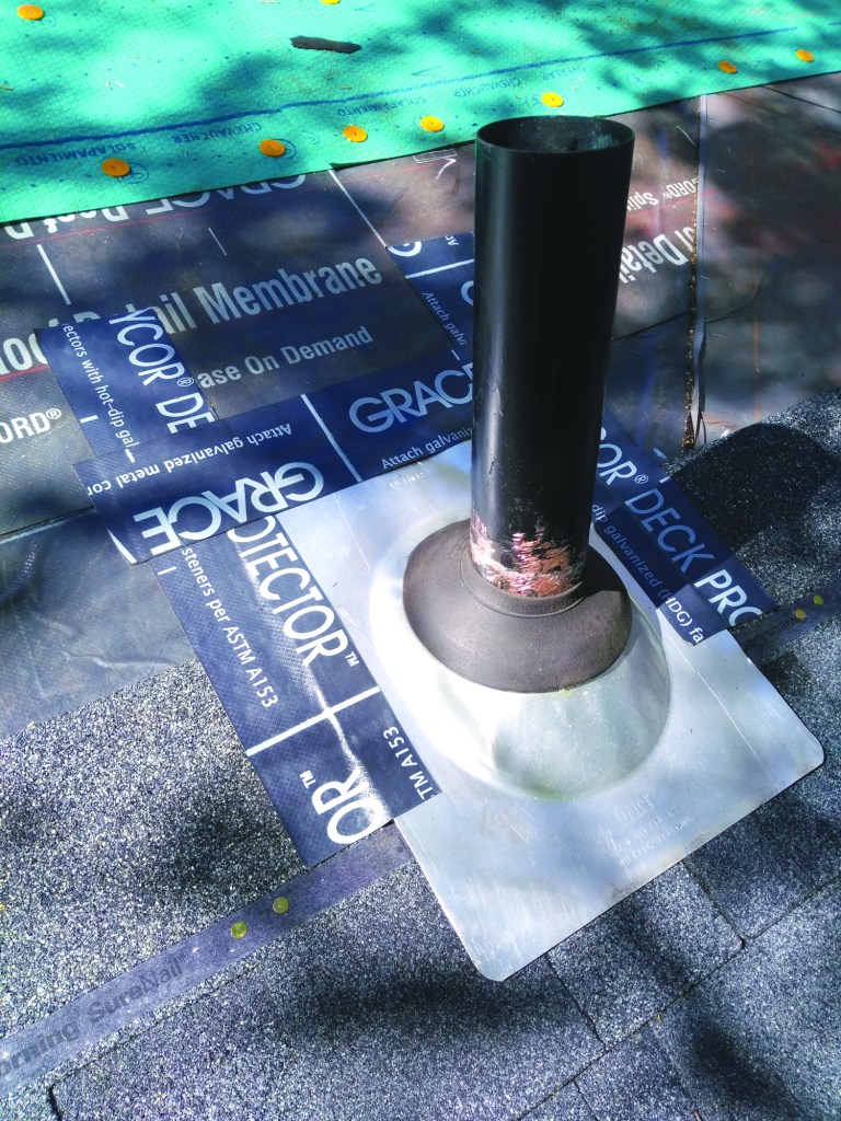

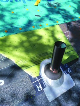

Notch a section of underlayment material around the boot, letting it extend under the next course of roof underlayment above the boot.

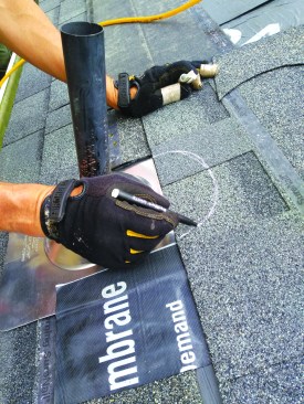

Scribe and fit the shingle courses around the boot in typical fashion.
