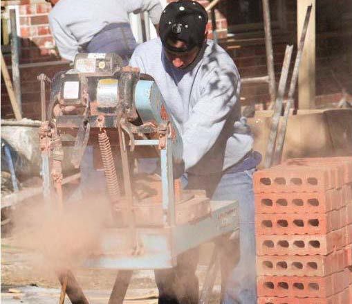

News about OSHA’s proposed silica rule has been bubbling up for a couple of years. It has caused near-conniptions in the mining and oil industries, which would be heavily impacted by such a ruling. But the new rules could require any worker cutting into stone, concrete, block, glass, or ceramic—perhaps even such mundane tasks as sanding drywall—to implement a host of control measures (wet saws, vacuum dust collection, and worksite isolation being the predominate ones).
Writing in Remodeling magazine, Charlie Wardell unpacks what the proposed silica dust rule could mean for remodelers in “The Fed’s War Against Silica Dust.” Masonry and drywall contractors would be the most affected among the residential trades, Wardell writes, but the rule could apply to any worker generating dust. Cutting concrete, tile, block, and pavers; grinding or sanding a stone countertop, gutting a small bathroom, and roofing with tile are all tasks that could be regulated. The measures go beyond limiting the amount of dust generated and wearing respirators. Remodelers will need to establish written protocols, in addition to training workers how to recognize hazards and how to use personal protective equipment.
