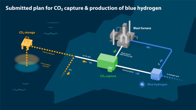

An illustration of Tata Steel's decarbonization plan
courtesy Tata Steel
Most steel manufacturers employ blast furnace (BF) technology to convert iron ore, coke, and limestone into crude iron and carbon dioxide. The iron is further processed in a basic oxygen furnace (BOF), producing low-carbon steel with an additional release of CO2. The energy-intensive nature of BF-BOF steelmaking leads to high carbon emissions, on the order of 1.73 tons of CO2 per ton of resulting steel. Although attaining net-zero carbon with the BF-BOF process is challenging, incremental improvements are possible. One approach involves altering the blast furnace mixture by reducing the amount of coal used to make coke and increasing the amount of iron ore. Another method deploys gas from coke ovens to offset some of the primary energy for the blast furnace. According to Resources, the most effective way to reduce CO2 emissions in BF-BOF steelmaking is to employ a carbon capture, utilization, and storage process. For example, Tata Steel in the Netherlands is developing a way to sequester the CO2 emitted from steel production in depleted natural gas fields under the North Sea. The company predicts that this method will reduce 40% of its carbon emissions by 2030.

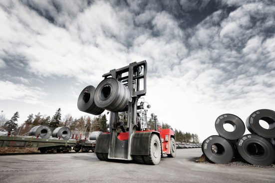

The Sweden-based steel manufacturer SSAB is already producing commercially available steel this way. Utilizing green hydrogen instead of coal and coke, the company has created “the world’s first fossil-free steel.” The achievement, called HYBRIT, is the result of a five-year partnership between SSAB and energy company Vattenfall, and represents an endeavor to improve the environmental performance of steel-making. SSAB produced its first batch of HYBRIT steel in July and delivered it to the Volvo Group. Although the SSAB’s production facility in Oxelösund has yet to be converted to EAF technology—that advancement is slated for 2025—the use of a renewable, fossil-free energy source represents a compelling means to accelerate green steel production. SSAB aims to scale HYBRIT in 5 years, ultimately reducing Sweden’s CO2 emissions by 10%. According to Anna Borg, president and CEO of Vattenfall, “Electrification is contributing to making fossil-free living possible within one generation.”
SSAB also plans to deliver its fossil-free steel to the cargo and load solutions company Cargotec
courtesy SSAB
