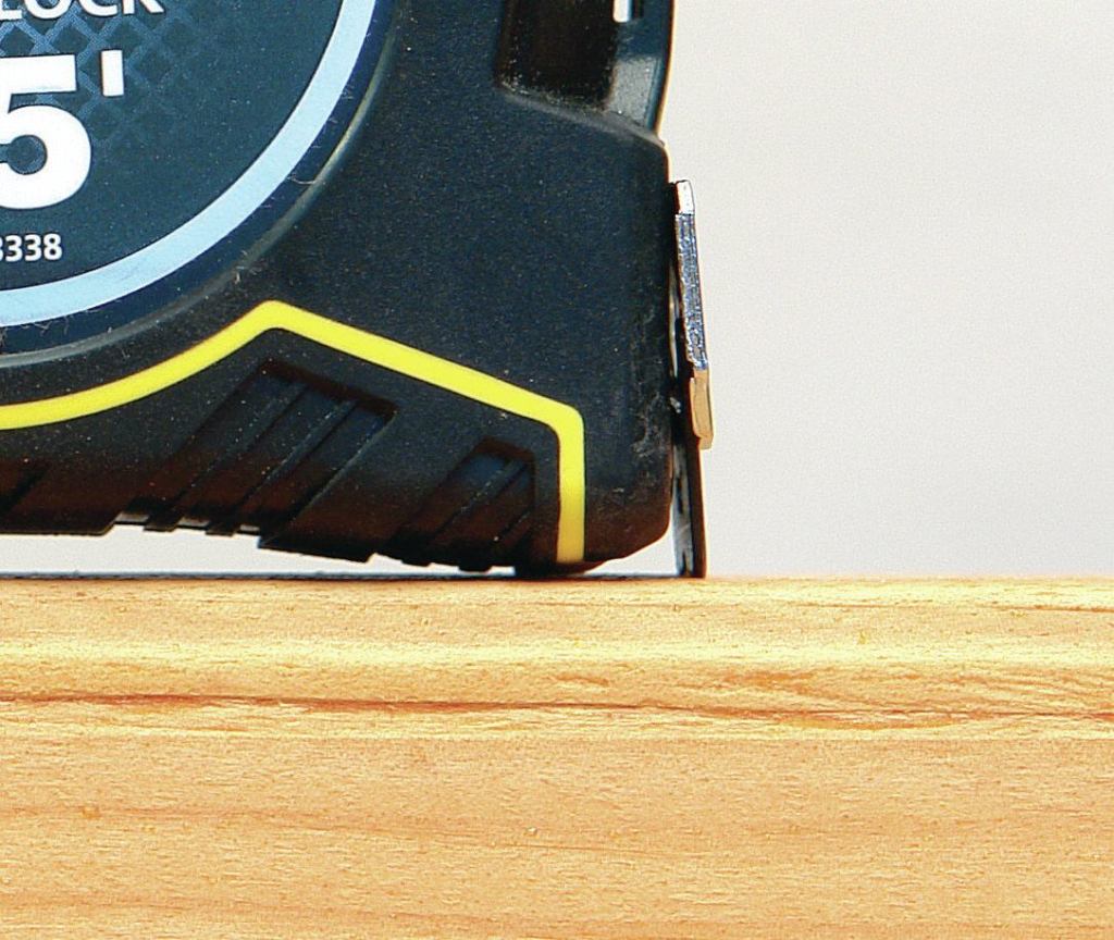

Auto-locking tape measures normally have a spring-loaded bottom lever that you squeeze when extending the blade and release to lock the blade. Squeeze again and the blade retracts. Stanley’s new 25-foot FatMax auto-­locking tape measure simplifies that procedure. It locks automatically when the blade stops extending; to release or retract the blade, you simply press the top-forward release button. To override the auto-lock, slide the same button up until it clicks.
The new two-piece blade hook is also unique. According to Stanley, most framers like oversize hooks that can grab edges from the top, bottom, or sides, while finish carpenters like standard hooks because they don’t get in the way. This tape has a standard hook along with a removable, oversize hook attachment that stores in the tape body and snaps onto the hook rivets when you need it.
“I like the new tape’s auto-lock and override,” Goodrich says. “But the bottom edge of the blade hook is flush with the base of the tape measure, which makes it hard to hook the edge of a material without extending the blade first. That extra step wastes time, and it drives me nuts. I’ll stick with my other FatMax tapes for now.”
