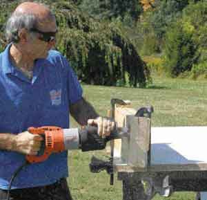

Testing
In addition to using the saws on all my projects for several weeks, I did some more objective cutting tests.
For the first one, I nailed together a header from some salvaged 2x10s. I included 1/2-inch OSB sheathing on one side. I made six cuts with each saw — three in the straight-cutting mode and three more in orbital mode — and then averaged the times. I used a new 4-inch Lenox demolition blade in each saw. In straight mode, the Milwaukee came in first, with the Makita second. In orbital mode, the Makita finished first, the Milwaukee second.
To test metal cutting, I screwed 3/4-inch metal curb stakes to a sawhorse and made a pair of cuts, one in each mode. In straight mode, the Milwaukee came in first, again followed by the Makita. In orbital mode, the Makita finished first, followed by the Porter-Cable.
