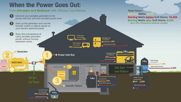

The trick is to use a soft-start unit, a device most serious RVers are familiar with. It reduces the surge of power needed to start up appliances — that’s why lights flicker when the A/C kicks on — so a small backup generator can run a larger electrical load.
“Soft start technology has been around for 30 years, but what’s new about it is how it’s being used,” explains Aaron Fagan, an energy consultant and owner of Atlantic Energy Sales Group based in Maryland. By that, he means soft starters can be used in conjunction with several other pieces of equipment to ensure homeowners can ride out emergencies in comfort and security with a smaller, more affordable 9-kilowatt propane generator.
Here’s how it works: A soft-start load reducer connects between the generator and the power inlet box, reducing starting watts of appliances downstream. A dedicated soft starter on a heat pump’s compressor further slashes inrush currents. The combination makes it possible for a heat pump, refrigerator, garage door, well pump, and other appliances to stay on with only a small backup generator. (You’ll need a transfer switch at the circuit panel to transfer supply to the generator.)
Fagan collaborated with the Propane Education & Research Council (PERC) and several manufacturers to assemble and field test a kit called Home Soft-Start Kit, which includes ActiveStart soft-start units from Active Controls, a DuroMax XP9000iH dual-fuel invertor generator, and a 50-amp transfer switch from Reliance Controls.

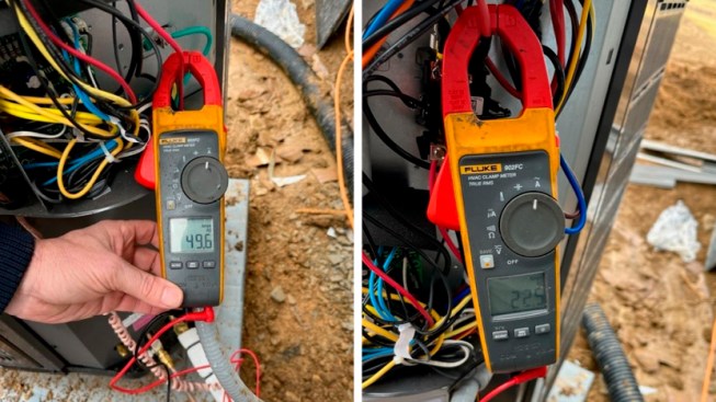

Holtzman Corp., a propane supplier serving Central Virginia, recently tested Home Soft-Start Kit for a manufactured homebuilder. The soft-start unit cut a heat pump inrush current (the surge at startup) by half, as you can see on the HVAC clamp meter.
In one field study — there are currently 10 ongoing — Holtzman Corp., a propane supplier in Central Virginia, found that the soft-start system dropped a heat pump’s start-up amps from 49.6 to 22.5. Not only are inrush currents halved but the soft starter will extend the lifespan of the heat pump motor and compressor, and reduce peak load on the grid.
