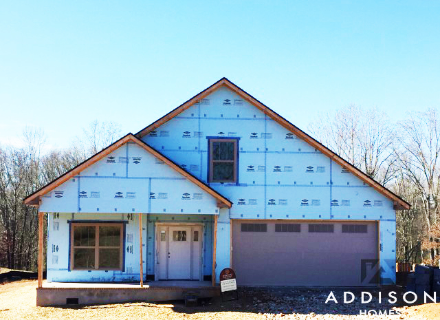

Above-code enclosure. While it's not required by code in climate zone 3, Addison Homes typically uses 2x6 framing (with R-20 cavity insulation) in combination with R-5 exterior insulation. The author has found this to be a proven solution for comfort, quiet, durability, and energy efficiency. Exterior insulation adds some upfront cost, but the payoff is felt immediately: more even temperatures, reduced noise, and energy savings that typically pay for the investment within a few years.
Above-code enclosure. While it's not required by code in climate zone 3, Addison Homes typically uses 2×6 framing (with R-20 cavity insulation) in combination with R-5 exterior insulation. The author has found this to be a proven solution for comfort, quiet, durability, and energy efficiency. Exterior insulation adds some upfront cost, but the payoff is felt immediately: more even temperatures, reduced noise, and energy savings that typically pay for the investment within a few years.

For Addison Homes, the preconstruction phase is where we take the proven practices from previous projects and then evaluate different systems, materials, and designs that support the goals for the current build. From our side, most of the performance-impacting decisions—like framing size—have already been made. We use 2×6 framing in combination with exterior insulation in all our homes to boost R-value in the wall assembly. For us, it’s a proven solution that delivers comfort, quiet, durability, and energy efficiency. So, while the questionnaire explores options like siding, flooring, countertop material, and basic lighting, some of the core design elements are simply the way we build homes and are simply part of the package when clients choose to build with us.

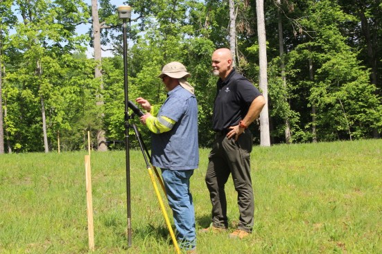

Solar orientation. Todd Usher works with a surveyor to orient the house for optimal solar and to maximize natural daylighting for an upcoming Addison Homes project.

That’s because we make intentional decisions during preconstruction that deliver those results. Take exterior insulation, for example. Sure, it adds some upfront cost, but the payoff is felt immediately: more even temperatures, reduced noise, and energy savings that typically pay for the investment within just a few years. These are the kinds of intangibles you can’t fully appreciate until you experience them.

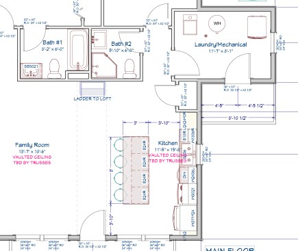

Same goes for hot water. Zero Energy Ready Homes require an efficient hot-water distribution system. Depending on the home’s layout, we’ll either centrally locate the water heater to reduce pipe length or install a smart recirculation pump that learns usage patterns and delivers hot water when and where it’s needed. Technically, we could say: “Your home will have an efficient hot water system.” But what the client hears is: “Your shower won’t start cold.”
Efficient hot water. Depending on the home’s layout, Addison Homes will either centrally locate the water heater to reduce pipe length or install a smart recirculation pump that learns usage patterns and delivers hot water when and where it’s needed.
