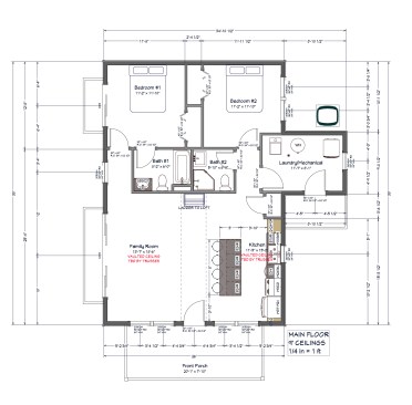

First floor plan
First floor plan
With the same expectations of quality and high-performance, specifically adhering to the ZERH program standards, we started the design process again but this time for a comfortable three-bedroom, two-bath unit.

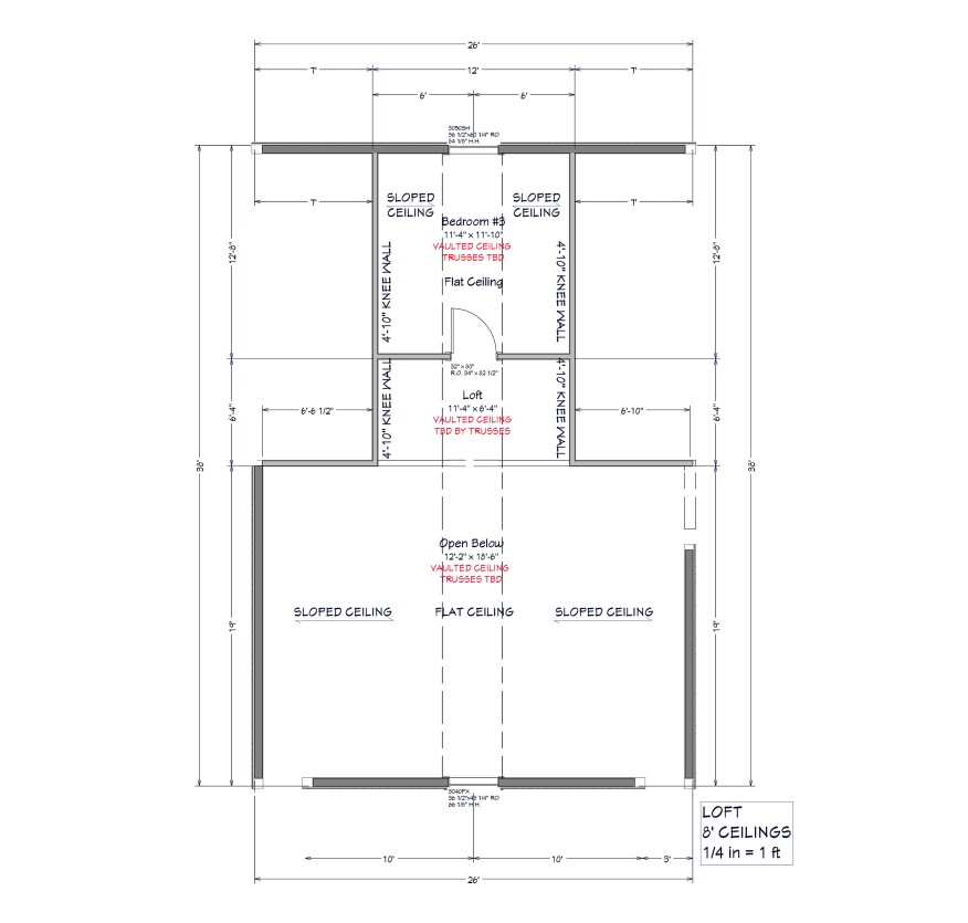

Second floor plan
Second floor plan
While specifying the details to ensure a tight building envelope, efficient HVAC system, and durable/resilient structure fell to my team, Mary took the helm on the floor plans and layout. The 1,300-square-foot two-level design meets her exacting demands of maximizing natural daylighting, opening spaces, and providing functional flow. A near perfectly aligned southern exposure to the main living space is utilized for maximum daylight during the shorter days of winter and affords passive solar heating. The roof was also optimized for southern exposure for solar PV.

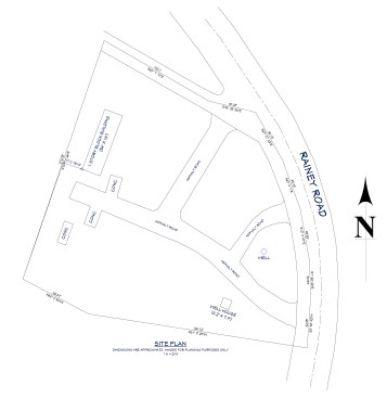

Site plan
Site plan
