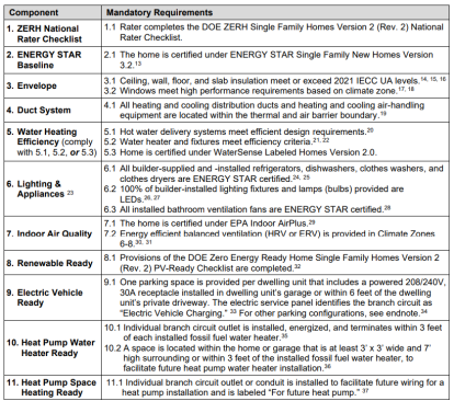

Homes that achieve ZERH certification must meet the rigorous performance criteria set for new construction by the federal government’s voluntary program. The program requirements are structured around a set of required specifications, followed by a performance threshold, and finally, third-party verification by a rater who inspects and tests the home to verify it meets ZERH technical requirements.
The required components include compliance with the Environmental Protection Agency’s (EPA) Energy Star for New Homes and EPA’s Indoor AirPlus requirements, and also require the home to be laser-focused on the best practices for insulation, HVAC, and water heating systems. These performance thresholds set the bar for energy efficiency levels. Builders can achieve compliance through prescriptive measures or energy modeling that allows for trade-offs in design and materials. This flexibility is ideal for builders who want to offer customers options while still delivering a home that meets the above-code energy efficiency performance levels set by the program.
The final step in the ZERH process is testing and verification of the home’s performance. The program provides detailed checklists for the rater to track clear and transparent documentation of the building envelope, duct system(s), water heating efficiency, lighting, appliances, and IAQ. Also important is that the home is ready to incorporate renewable energy generation and an EV charging station. When the inspection is complete, the rater submits the necessary documentation to obtain ZERH certification.
