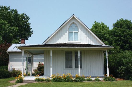

But what of the anonymous carpenters who built the house that encloses what must surely be America’s best-known window, Gothic or otherwise? Don’t they deserve some credit? In fact, the layout of the historic Dibble House—now owned by the Iowa State Historical Society—suggests that they do. The house is small, with a first-floor area of just over 500 square feet. To save space, the carpenters who built it in 1881 (a two-man crew sometimes identified as Busey and Herald) shoehorned the stairway to the second half-story into a rear corner.
According to modern-day Eldon carpenter Jason Snyder—who does repair and maintenance work on the house—the resulting stair is just 18 inches wide and turns left at a landing partway up. “A guy who’s 5-foot-5-inches can hit his head,” Snyder says. “There’s no way to move furniture up those stairs.”
Anticipating that difficulty, the original builders seem to have settled on a large gable-end window as a practical, if awkward, solution to the moving problem. The granddaughter of a former owner of the house told historians that the family brought in furniture by hoisting it onto the back-porch roof with a block and tackle, then manhandling it through the Gothic window—which the carpenters had thoughtfully hinged to open like a door.
