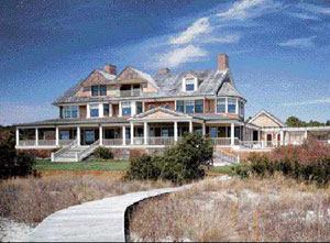

On a special lot on Kiawah Island measuring 100,667 square feet, Steven J. Koenig Construction built the Ballybunion residence designed by architect Robert A.M. Stern. The main house and a guesthouse comprise 9,777 square feet of conditioned space. The structure is built to V-zone flood standards, so the lowest floor is not included in the conditioned space but is dehumidified to provide suitable storage space for the owners.
