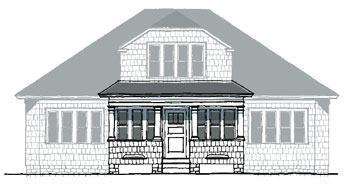

In this column, we’ll review several approaches to enclosing a porch on a small bungalow. The more successful designs balance the context of the main house with an enclosure that recalls the open porch that preceded it.
Original Porch
This New England bungalow displays the style’s trademark open front porch, composed of a shingle half wall on fieldstone piers with stout, square posts supporting the roof. The hipped roof and closed eaves are somewhat unusual for a bungalow and suggest the influence of the Prairie style. Because the open porch is rarely used, enclosing it to create a three-season room will add valuable space and daylight to the interior.
Enclosure With Double-Hungs
To enclose the porch, windows and trim are added above the half wall and in between the posts, while the existing exterior door is moved forward to give access to the new enclosure. Reusing the door helps maintain the building’s street-front character. An interior French door with narrow lights is an ideal replacement for the now-relocated exterior door. It’s wise to recess the front door and trim from the front of the posts to allow more of the post depth to be visible from the front, as in this example.
The shingled half wall that provided privacy to the open porch serves the same function in the enclosed porch. The windows let in plenty of daylight while keeping out wind and rain.
In this treatment, mulled double-hung windows with proportions similar to those of existing windows flank the door; four double-hungs of a slightly wider dimension fill in between the posts on the sides of the porch. The head and sill heights of the porch windows differ slightly from those of the house windows due to the existing porch frieze and rail heights.
Though this window choice seems logical, it creates a somewhat monotonous repetition of narrow double-hung windows, and it doesn’t acknowledge that the porch is an intrinsically different type of space than the rest of the house and should be treated accordingly.
Enclosure With Casements
Here, two casement windows that are approximately one and a half times the width of the existing narrow double-hung windows flank the door, while three casements of the same size as those on the front are used on the porch sides.
The choice of wider casement windows helps define the enclosed porch as an entity distinct from the rest of the house. The muntins further differentiate the space. The narrow window lights recall the narrow proportions of the existing windows — without literally reproducing those units.
Having fewer windows allows for a more open, porchlike feel. Since casement windows operate by swinging clear of the wall plane, they are typically less enclosing than double-hung windows, which operate within the plane of the wall. This scheme communicates that the enclosure was once an open porch and thus more clearly conveys the building’s evolution. Such an approach respects the original building while celebrating the new adaptation.
