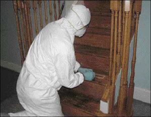

Mold work requires basic worker protections, including nitrile gloves, an N95 or N100 mask, safety glasses, shoe covers, and a Tyvek suit. If a remediation firm isn’t providing this level of protection for its crew, it may not be paying attention to other industry guidelines for safe mold removal.

The proper way to do tear-outs and remediation includes using containment barriers and negative air pressurization techniques to keep mold from spreading to places where it wasn’t present before. Containment often means sealing the area that’s being torn out with plastic barriers. DeCapri says that most professionals use the ZipWall product (www.zipwall.com), a dust-barrier system that uses telescoping twist-locking poles and plastic sheeting. Negative pressurization is simply a blower that sucks air out of the room. The blower should have a HEPA filter to catch spores as they pass through, to keep them from spreading to other areas. Before tear-out, George Harrison of AirScrubbers sprays drywall with ShockWave, an EPA-registered ammonium chloride cleaner (available from Fiberlock Technologies (www.fiberlock.com) that helps prevent spores from becoming airborne.
Containment also protects occupants from airborne spores, so how tight the barrier needs to be will depend in part on the occupants’ sensitivities, according to Light. “Most of the time we look at site-specific circumstances. In cases where no occupants will be exposed and the area can be protected before their return, we may not suggest full containment.”
Mold removal. Once the drywall has been hauled away, any mold on the framing will have to be physically removed. Sometimes it has to be scraped off the surface, and doing this incorrectly can also send spores airborne, so the containment barrier and fans need to be in place during this part of the job as well.
Semiporous materials like wood studs are usually cleaned and sanitized with antimicrobials. Most people assume that bleach is an effective mold remover, but while it may work on countertops and other hard surfaces, it’s ineffective on porous materials such as wood or drywall. “We’ve already had one call from a lady whose contractors sprayed studs with bleach, and mold is now growing behind the drywall,” reports Michael Gurtler, president of Gurtler Bros. Consultants, a New Orleans remediation company. Instead, remediators use special cleaners, like Fiberlock Technologies’ AfterShock, to kill spores. Gurtler also coats wood framing with an antimicrobial sealant that dries to a plastic-like film, permanently trapping the spores in the wood (available from Foster Products, www.fosterproducts.com). He cautions that some contractors are using the right chemicals but not following the instructions from the manufacturer. “These products are very expensive, and some people try to spread them thin to save money,” he says. “But each manufacturer requires specific amounts of coverage, and if the sealant isn’t applied thickly enough, it will shrink as it dries, leaving gaps that allow microscopic mold spores to creep in.”
