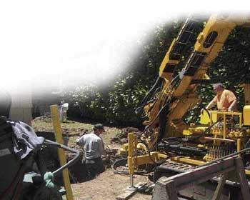

Installed costs are about the same for direct-exchange and water-source geo systems, though both are several thousand dollars more than a conventional air-to-air heat pump. With direct-exchange systems, however, small-diameter drilling for a geo field can achieve near “surgical” insertion of the ground loops, accomplishing the task quickly and with much less disturbance to the surrounding landscape than is the case with water-source systems.

By contrast, direct-exchange technology circulates refrigerant through highly conductive copper earth loops that are inserted into small-diameter boreholes of 50- to 100-foot depths, then embedded in sand or a protective thermal grout that enables direct transfer of energy with the earth.
