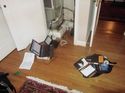

That’s when we decided to buy some data loggers so we could see exactly what was happening. There are certain problems that are hard to catch because you may not be at the house when they happen. We’ve found data loggers to be invaluable for evaluating HVAC performance, condensation, and other temperature problems, especially when they are complicated or occur intermittently.

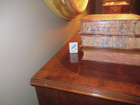

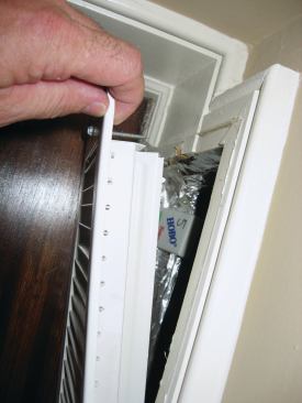

A typical scenario is one room that overheats on a hot day but is fine most of the time. In a case like this, with one problem area, I would normally put one temperature/humidity recorder in the problem room, another near the thermostat, one outdoors to record the ambient temperature, and typically at least one more somewhere in the house—perhaps in another room that isn’t having problems.

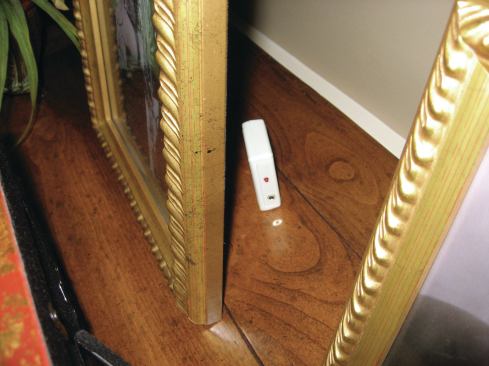

Keeping the recorders out of the sun is important. The recorders also have a blinking LED that can be annoying. For both reasons, I typically hide them behind pictures or books on shelves or tables. We also put one near the thermostat (but not on the thermostat; some high-end communicating models can produce heat).
Onset makes special outdoor sensors with built-in shades to keep direct sun off, but I haven’t bought any of these; I just put a recorder in a Ziploc bag and tape it somewhere on the north side of a tree or perhaps on a shady screened porch.
I’m always careful to make a list of which recorder is placed where. (I numbered ours with a marker when they first arrived.) When I use more than a few recorders, I take photos of where I’ve placed them. After two or three weeks managing 12 recorders, it can be difficult to find them all.
Logging Data
Typically, I’ll wait for the weather we need to get good information—in our typical scenario, a hot few days—before returning to collect the recorders. I connect them to a laptop on site and download the data. I use the Onset software to graph the data, which I find more digestible than the tens of thousands of data points. Sometimes I export the recordings into Excel if I want more graphing options.
The graph will show when (if ever) the room overheats—what time of day, what outdoor temperature, and what temperature the rest of the house is. Sometimes we find that the entire zone isn’t holding temperature, indicating we might need more insulation or more air conditioning. Other times it’s just the one room, in which case we might need more supply air or a high return in that room to fix the problem. In the case of the cold bedroom, the data allowed our HVAC guys to see that there could be a problem. We first tried adjusting the existing system, but in the end had to install a zone damper to finally resolve the issue.

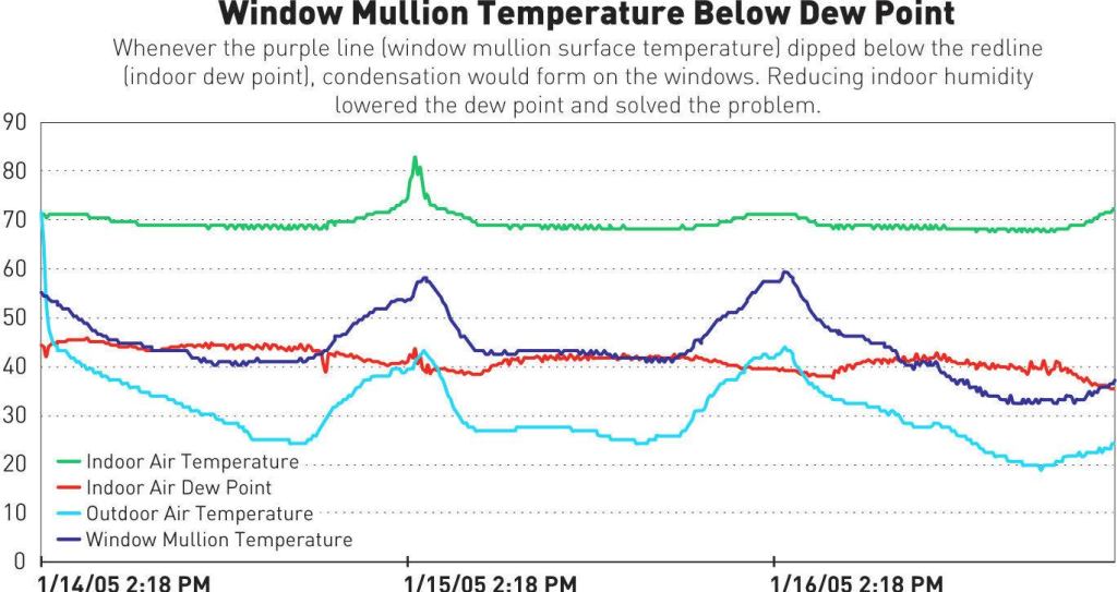

We had some beautiful steel casement windows installed by a factory crew on a large remodel. However, even during construction, we noticed condensation forming on them. The clients called us in a panic during the first cold snap of the winter. They woke to find the window frames coated with ice melting onto the wood floor.
The architect had specified these units for other houses without mishap, so he reasonably thought that the installation might be at fault. Our HVAC contractor didn’t think the humidification equipment was unusual either.

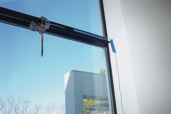

We set up recorders to measure indoor temperature, indoor humidity, outdoor temperature, and using the remote temperature sensor, the temperature of the window frame. When the next cold snap hit, we were able to show that the inside surface of the window frames was below freezing when the outdoor temperature dropped below 20° F. Using the built-in features of the Onset software, we could show that the window frames dropped below dew point, even when outdoor temps were above freezing (see graph, above).
With this information, the conversation changed from an installation question to a humidity management question. Our HVAC contractor installed outdoor temperature sensors to turn off the humidifiers below an adjustable point. We used the recorders to home-in on the proper set-point and to show the anxious homeowners that the dip in indoor humidity was brief and not too severe. A third-party engineer was brought in to consult. After seeing a graph of the frame temperature dropping below dew point, and even below freezing, he wrote a letter to all parties explaining that the recordings conclusively identified the problem and our solution was probably the best one.

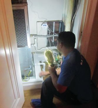

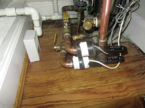

In a high-end condo we renovated, the water-to-air HVAC unit had shut down on several hot afternoons, leaving our clients without AC. But two similar air handlers in the same apartment —and units in apartments above and below—didn’t have issues.
After several troubleshooting visits, our HVAC techs were pretty sure the problem was inadequate water flow provided by the building’s common system. Rather than point fingers at the building staff and have our clients experience another failure without knowing for certain what the issue was, we set up a monitoring system that would allow us to monitor the building water-flow rate and temperatures live over the Internet. With this setup, we could definitively see what the issue was. The HOBO ZW software even allowed us to set “alarms.” When the temperatures or flow went out of user-selected ranges, the system would email a warning.
Whether spurred on by pride in their work (they are good guys), or by the impending arrival of our flow-rate monitoring system, the building staff thoroughly checked and cleaned the pipes and valves running to our client’s unit. Afterward, we had good flow and temperature almost all summer and never had a problem with the AC again.
This was not a case where the data helped us find a specific issue. But it is a case where everyone involved was glad to have conclusive evidence that all was well. Clients were happy (in fact, they seemed to enjoy checking the live flow rate and temperature “dashboard”), and if there had been an issue, we would have been able to find and fix it.
