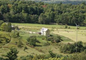

By definition, this net-zero home (top) produces at least as much energy as its occupants consume in operating heating, lighting, and other electrical appliances. It stands on a picturesque property (above) in northern Vermont and incorporated a wind turbine and a geothermal system--among other devices--to balance energy supply and demand.
