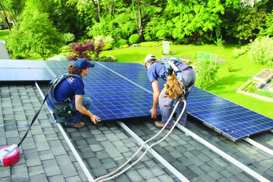

The cheapest and the simplest way to mount solar panels is on a rack in plane with the roof. In that case, the angle of the solar panels to the sun is the same as the roof’s angle. The panels will be directly perpendicular to the rays of the sun—their highest-output condition—when the roof is. So ideally, the roof will be framed at that pitch. The highest solar output for the year will happen on the days when the sun is shining directly down on the face of the solar panels. The roof angle determines which days that will be.

Thomas Tutor, a solar design specialist with ReVision Energy in Maine, confirms the point. “One of the common misconceptions is that a solar roof has to face due south. Of course, if you’re building new, and you have a choice, orienting it due south is ideal. But anywhere within 45 degrees east or west of that is very good.” A house facing 45 degrees off of due south still produces 90% of its potential power, says Tutor.
Charlie Morgan, of Eastern CT Solar in North Stonington, Conn., handles Nick Lehto’s solar panel installs. Morgan says, “Most of the houses I do are retrofit projects. I think the same is true of most solar installers. So you have to work with what you’ve got. A lot of times that roof is not oriented toward perfect south. That doesn’t mean it’s not a good roof for solar. Solar south is ideal; once you start moving east and west of south, you start losing some production and some efficiency in the system.”
But non-south-facing roofs can still produce a lot of power. Says Morgan: “If you had an optimum south-facing roof, you’d be at 98% production; if you had an east-facing roof at a 35-degree pitch, you’d be at 80% production. And if you were east at a 21-degree pitch, you’d have about 84% because there’s less shading by the roof. So that flatter roof helps you out a bit.”
Thomas Tutor points out, “With a zero-degree pitch—so, a flat roof—it doesn’t matter which angle it’s facing. That’s sort of obvious, but you get the idea: At a flatter pitch, the home’s orientation angle is less important.” For houses that don’t face due south, a flatter roof can be an advantage, Tutor explains: “For example, if you have a 20-degree pitched roof, and you are facing true south, you are at 96% solar tilt orientation factor. If you went down to a west roof, you are at 80%. But that 80% is better than a 40-degree pitched roof that is also due west. Because that flatter angle can still catch a little bit more of the sun’s rays when it is to the south.”

Given the declining cost of solar panels, builders may find it practical to make up for imperfections in roof slope or orientation by simply adding more panels where space allows. Says Morgan, “We often do that. It makes the project more expensive, because you’re trying to make up for lower efficiency by throwing more money at it, but it’s doable. And with the price of solar panels not the limiting factor that it was, adding a few solar panels doesn’t generally break the bank anymore.”

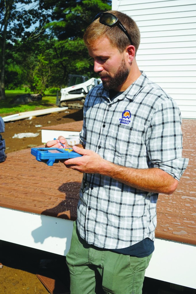

Shade on the roof, on the other hand, can be a significant issue. “The big bugaboo now when you’re trying to design a system and optimize production is less the orientation and more making sure that you’re not encumbering yourself with any shading from trees,” says Morgan. “You want at least six hours of open sky. We kind of use the window between 9 a.m. and 3 p.m. on a south-facing roof. You don’t want any shading on the array, because that will really reduce your production.”

There are a couple of ways to evaluate a building site’s shading situation, says Morgan. “We have a tool that we can go up on the roof with, called a Solmetric SunEye (solmetric.com). It takes a fisheye view of the sky, and you can calculate the amount of shading potential for different times of the year. But even easier than that now is a software that is available that allows you through satellite imagery to model the irradiance on a given site remotely using Google Earth. So I can take a Google Earth picture, draw my array on it on the computer, and then add in the trees, and the software will calculate the shading and the production for me. That’s called Aurora (aurorasolar.com).”
