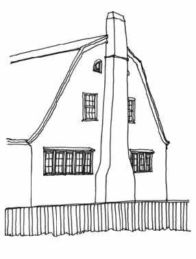

Simple Stucco Chimney
This centered end-wall chimney is made of smooth stucco. It tapers noticeably above the firebox, then continues to taper more gradually as it rises; a foot or so from the top, it narrows noticeably again.
Like the windows and house trim, the chimney is mostly white, except for a single band of black above the quarter-round windows and a black cap at the final taper. It's a simple, elegant treatment that doesn't overshadow the flanking window arrangements.
