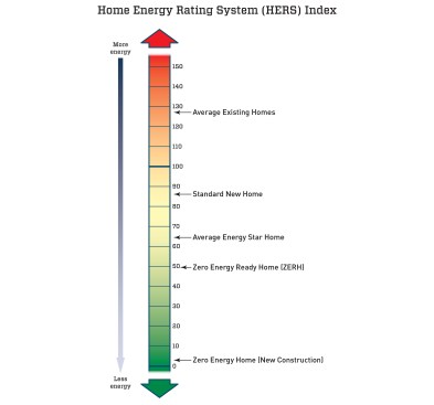

ZERH homes are designed to achieve a HERS (Home Energy Rating System) score of 50 or less, which is at least 50% more efficient than a standard reference home, and about 25% more efficient than the average Energy Star certified home (see image below). Builders of ZERH homes are eligible for the 45L federal tax credit of $5,000 per unit.
