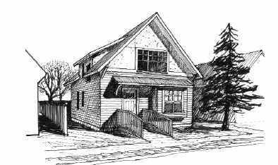

Let’s start with one of my favorite prototypes, the “story-and-a-half” houses so common in the Northeast. You see them everywhere: Look for eaves set halfway up the second-floor wall. When dormers are present, they interrupt the eaves — a really nice effect. The spaces on the second floor are intimate and varied because they are partly under the eaves.
The structure may be derived from the Greek Revival style, where the first-floor girt frame extends past the second floor to create a wide entablature. This stub wall also creates usable space on the second floor, which otherwise lacks headroom due to the low roof pitch demanded by the style.
That same construction (with a steeper roof) is used in the story-and-a-half homes. The side windows are narrow, and dormers are set over the windows below so that as many studs as possible cantilever to resist the roof thrust. This example from West Falmouth, Mass., lacks dormers, but it has porches on two sides and a wing out of sight at the rear.
The style can yield a handsome and economical house without a lot of trim. Here is a sketch of an accessible home (bottom) that illustrates what you can do. It shows a shed dormer, a shed roof over the entrance, and a shed-roofed bay attached to the front. (I am a fan of hanging bays from the wall instead of building an expensive foundation.)
With contemporary platform framing, it’s best to carry the roof on a ridge beam to eliminate the thrust. This gives you complete freedom to locate windows and dormers where they work best with the furniture. A taut design without overhangs may get you in the magazines, but overhangs really help keep a building dry, with or without gutters and leaders. The main complication with the roof is the double cantilever at the corners (I recommend using a simple bracket to avoid rake outriggers).
Homes need enough detail to make them authentic. We need to build affordably, but if we just say no to wide lots, we will save more than enough to justify a little decoration.
