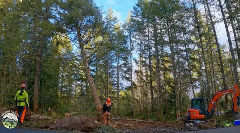

I work for my family’s company building spec homes. We don’t sub-out the framing, foundations, and siding. That’s my role. In this video series, I’ll show how our crew approaches the construction of a spec home, starting with clearing the land and followed by videos on the foundation, framing, siding, roofing, and other features. Along the way, I’ll cover some of the high-performance features of this house and our focus on energy efficiency, but I’ll also talk a lot about our methods of work and many of the decisions that have to be made during the building process.
We used to hire excavators to clear and grade our sites, but recently we haven’t been able to find that service in a reasonable time. So we took that on ourselves, too. In this first video, I show how we cleared the land.
