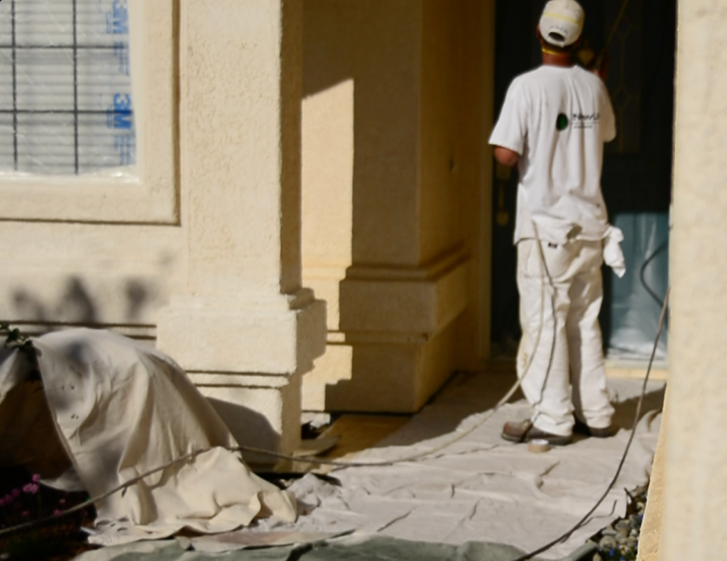

- Cover furniture with plastic or fabric sheets
- Lay down moving pads for carpet
- Shoe covers are required when we enter a property and removed when we leave a home to avoid tracking anything back inside

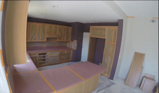

- Use Red Rosin paper and Ram Board to form a protective barrier
- Lay drop cloths to protect surfaces while painting

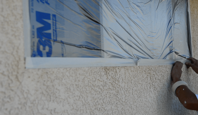

Here’s a New Life team member putting up plastic sheeting and painter's tape to protect the customer’s windows.
We use Red Rosin paper and Ram Board to protect cabinet doors, which can collect fine construction dust.
