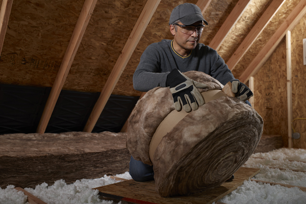

An evaluation of the entire energy system, including the make-up of the home’s current insulation mix, is critical in determining what additional products are needed to further optimize the home’s building envelope. This type of evaluation can prevent an upgrade in one area from impacting another area. For example, simply adding insulation into the attic, without reducing ceiling air-leakage or maintaining attic ventilation, could result in unintended consequences related to roof moisture and unrealized energy savings.

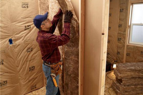

Key benefits of combining insulation products include significantly improving the energy efficiency of a building and potentially cutting project costs. An obvious advantage of combining insulation products is that it gives remodelers the ability to leverage the functions of multiple materials at different cost options to find a mix that best fits within the project scope.
For example, spray foam insulation provides excellent thermal performance, as well as advanced air and moisture control, but tends to cost more than other insulations. In this case, a product mix or hybrid solution is ideal.
Hybrid insulation systems help create custom insulation solutions that meet high demands and diverse project needs. Consider working with an insulation contractor to install a hybrid of spray foam with fiberglass batts or rolls, combining the air-sealing and vapor-retarder benefits of foam with the economical and thermal benefits of fiberglass. An alternative solution may be to install batts or rolls throughout the project and use spray foam for hard-to-reach places and for air-sealing, reducing any draftiness.

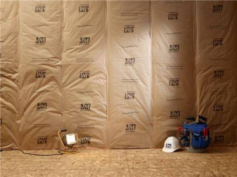

Lastly, align insulation upgrades with the project scope. For example, a basement remodel is an opportunity to deliver not just a code-minimum room, but a comfortable and dry living space. Let the project scope and timeline guide opportunities to upgrade insulation. If the project calls for new windows or walls, work with the insulation contractor to ensure the insulation, caulking and air-sealing are all up to par.
Another project type to consider is upgrading insulation during “curb appeal” projects. Replacing the siding, doors, or windows on a home is a perfect time to evaluate the home’s energy efficiency levels and add more insulation and air-sealing. Replacing siding can allow for the addition of foam sheathing, or possibly even adding drill-and-fill insulation from the outside.
