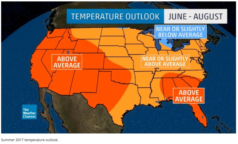

Already the Weather Channel is predicting warmer than average temperatures for much of the country throughout the summer, especially the South and West. And though not all homes are set up for air conditioning, new technology makes it possible to bring relief into almost any part of the home for less. That’s important because maintaining consistent temperatures and airflow accounts for about 50 percent of all energy use in a typical home — the largest single energy expense, according to the Department of Energy.
