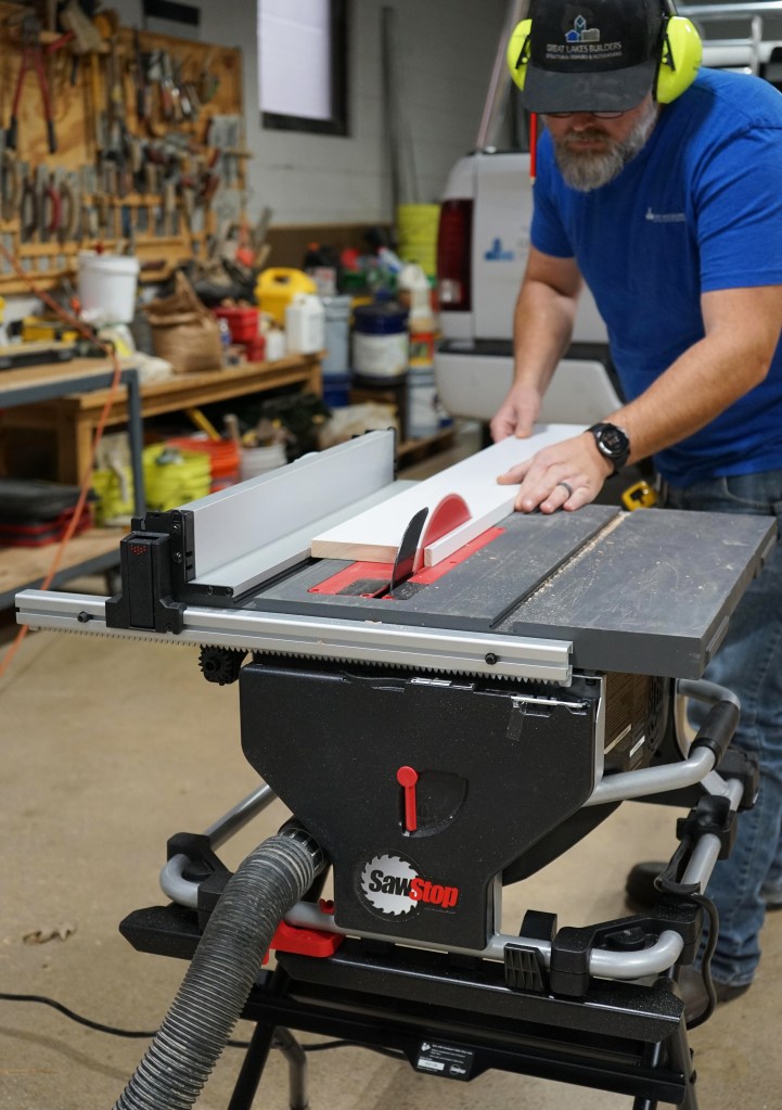

  • It has a rack-and-pinion fence that holds the fence square to the blade. This has proved very reliable and looks like it will stay that way for the life of the saw. The fence has what SawStop calls a “high and low face,” which means the fence includes a “low face” spacer that separates the material you are cutting from the “high face” (main body) of the fence, giving you more room for your hand or a push stick between the blade and the fence. This also helps reduce the chances of material binding between the blade and the fence.
  • SawStop offers a well-thought-out folding stand for the CTS. This retails for an additional $130, which I would recommend. The simple quick-release connectors (one at the front, one at the back) that secure the saw housing to this stand make for an especially easy setup and breakdown.
  • Dust collection appears to be better than any other compact saw we have run in the past. The port pulls air and dust from directly below the blade. This is a vast improvement over many saws that simply have a port coming out the back of the housing.

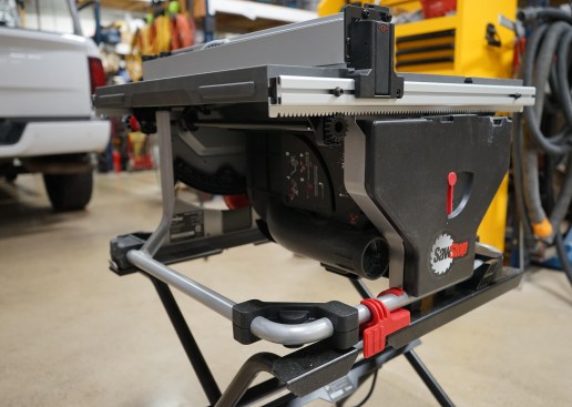

The rack-and-pinion fence on the CTS reliably holds the fence square to the blade.  The red quick release  (in foreground; there is another on the front of the saw diagonally opposite this one) secures the saw housing to the folding stand (available as an added accessory). Note, too, the 2 1/2-inch dust collection port, which pulls from directly under the blade. This configuration noticeably collects dust better than many other compact table saws.

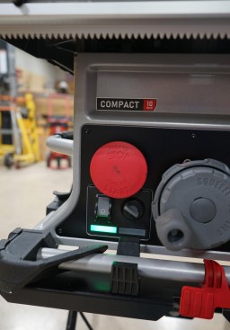

The large red paddle button to stop the saw is nice. To start the saw, you pull the red paddle out, then activate the main switch (gray button with white circle). To deactivate the brake cartridge (or put the saw in "bypass ") is required when cutting wet material, such as pressure-treated lumber, which the author's crew does frequently. To do this requires turning the bypass switch (to right of main power switch) while pulling the red paddle button out. The author would prefer a simple on-off switch for the safety system.
The large red paddle button to stop the saw is nice. To start the saw, pull the red paddle out, then activate the main switch (gray button with white circle). Deactivating the brake cartridge (or put the saw in "bypass ") is required when cutting wet material, such as pressure-treated lumber, which the author's crew does frequently. To do this requires turning the bypass switch (to right of main power switch) while pulling the red paddle button out. The author would prefer a simple on-off switch for the safety system.
Cons. There was only one minor thing that bugged me:
You need to deactivate the SawStop safety brake to cut wet lumber. That in itself is not the problem; it’s that putting the saw in this bypass mode requires two hands (see photo, above). As an employer, I found this problematic, because the guys were putting the wood on the ground to deactivate the safety system. Or even worse, they were deactivating the saw, then walking away from the saw while it was running to grab the material to cut. I would prefer a simple on-off switch. The onboard warning lights on the saw make it clear that the brake system is deactivated, so you’re not likely to forget you turned it off. And when the saw is switched off, it automatically returns with the brake system activated.
