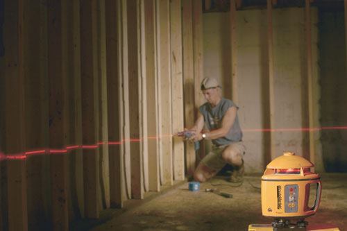

Going straight: Laser level lines take the guesswork out of where to drill for wire, pipe, and tubing--all of which go in easier through a straight run of holes.

Other electricians, and plumbers, are using rotary lasers to lay out for drilling through studs or joists. Rotary lasers work best for this task because, unlike line lasers, a rotary laser “wraps” around one face of the framing member, eliminating much of the guesswork in deciding where to drill. While this may seem a bit much–really, how neat does the stuff that’ll get buried behind the drywall have to be–lasers don’t take much more time to set up than snapping a chalkline.
For plumbers, having holes that line up exactly makes running rigid pipe much easier. And even if you’re pulling flexible pipe, such as PEX tubing, the reduced friction offered by perfectly aligned holes is welcome. Electricians benefit in the same way, particularly if you’re using stiff combo cable, where Cat 5, cable, and high voltage lines are all bundled together.
