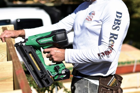

Over my 30-year career in the trades, I’ve used many different air-powered and cordless nail guns, so I was excited to try Metabo HPT’s new 36-volt MultiVolt 3 1/2-inch cordless framer and see how it stacked up against the others. The first thing I noticed when I took the Metabo out of the box was the weight, which is almost 11 pounds with the battery installed in it. Though that’s at the high end for battery-powered nailers, the tool felt balanced when I picked it up and held it for a little while. Pneumatic nailers are lighter, of course, and if they are coil-style instead of having a straight magazine like this one, they can sometimes feel lopsided when they are loaded with a full coil of nails. This nailer comes in both a round-head 21-degree version (model NR3690DR), which is the one we tested, and a clipped-head 30-degree version (model NR3690DC).

Both clipped-head and round-head versions of Metabo HPT’s MultiVolt cordless framing nailer are available; the author tested the round-head version.
