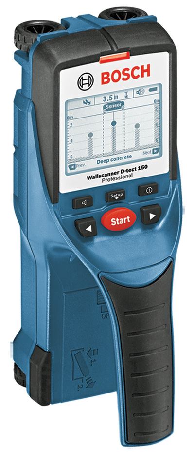

Bosch’s D-tect 150 is a hand-held detection device that uses ultra-wide-band radar to pinpoint the location, depth, and diameter of components in floors and walls. And it can determine — within limits — what those components are, allowing contractors to cut or drill into walls and floors without having to worry that they’ll hit something they shouldn’t.
You operate the device by rolling it across the surface and reading the scan results on an LCD screen. Separate modes scan cured concrete, green concrete, floors containing hydronic heating, and surfaces covered with drywall. The tool can detect metal studs and live AC wiring, and distinguish between ferrous metal (such as rebar), nonferrous metal (such as copper pipe), and nonmetal objects like studs and plastic pipe. In deep-concrete mode it can scan up to 6 inches beneath the surface; other modes don’t go as deep. Price: $750. 877-267-2499. www.boschtools.com.

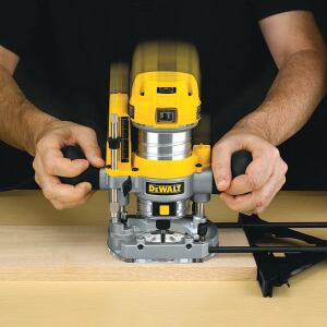

Routers have traditionally been small, medium, or large — but that changed when DeWalt introduced the DWP611, a “tween” size model that is larger than a trim router but smaller than a standard (medium) router. With its 7-amp motor and 1/4-inch collet, this tool is small enough for comfortable one-hand use yet powerful enough for the day-to-day routing tasks performed by carpenters and woodworkers.
It has a rocker-style switch on the front of the housing with a speed-adjustment dial above it. The motor operates between 16,000 and 27,000 rpm and contains soft-start circuitry designed to maintain constant speed under load. One of the tool’s better features is a pair of LED lights that shine down from the motor to illuminate the work.
The router is available as a fixed-base unit or in a fixed/plunge-base combo kit that comes in a soft storage bag. The plunge base accepts universal template guides and is particularly handy for mortising hinges and shallow hardware. Price: $125 (standard base); $180 (kit). 800-433-9258. www.dewalt.com.

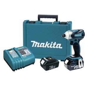

A number of things set the Makita LXDT01 apart from other 18-volt impact drivers: It is extremely short front-to-back, is one of the lightest models with a full-size (3.0 Ah) battery, and is part of a select group of tools with brushless motors and variable-power output. We tested it for an article in the Fall 2011 ToTT and it performed near the top in our runtime and timed driving tests.
Details include a belt hook, a one-handed chuck, and an LED light with a 10-second delay. Although the tool doesn’t have a battery gauge, it does have a warning light that comes on when the battery is low. And it has a nice charger — fan-cooled and with indicators that show the level of charge: below 80 percent, 80 to 100 percent, and 100 percent.
The kit includes two lithium-ion batteries, a charger, a belt clip, and a plastic tool case. Web price: $340. 800-462-5482. www.makitausa.com.
