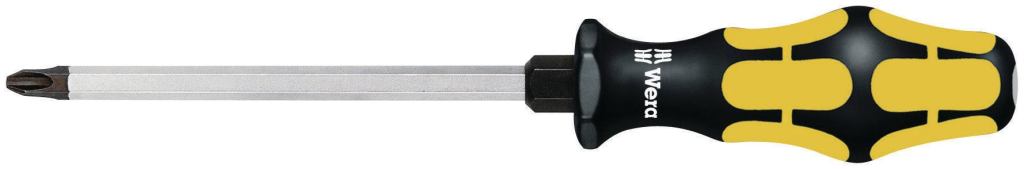

Wera Chisel Driver
There is more to The Chisel Driver than meets the eye. The screwdriver’s hardened tip and shaft that goes all the way through to a metal cap allows you to beat on it like a chisel without fear of damage. Where the shaft goes into the handle, there is a hexagonal bolster that you can grab with a wrench to assist in breaking free seized fasteners. Higher torque can be achieved by attaching a 1/4-inch ratchet or T-handle to the recessed female drive in the end of the impact cap. The easy-to-grip Kraftform handle helps prevents blisters and calluses. Chisel Drivers are available for slotted, Phillips, square-drive, Torx, and a variety of security screw patterns. Made in the Czech Republic, they have a lifetime warranty and are sold individually or in kits with prices starting at about $18. weratools.com
