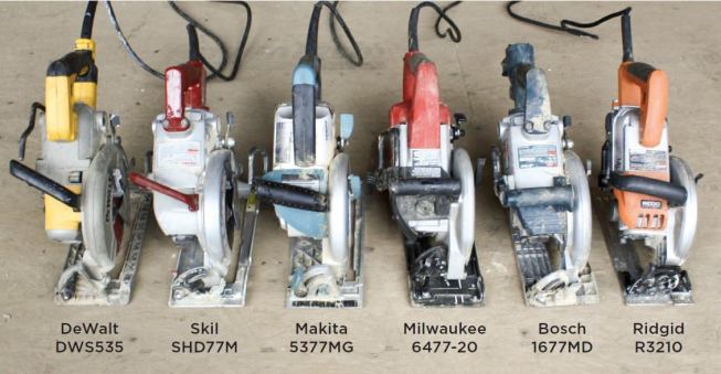

As a framer, I prefer inline saws to sidewinders because they’re more durable and less likely to bog down in heavy cutting. What distinguishes an inline saw from a conventional model is the orientation of the motor – it’s parallel to the base, so special gears must be used to transfer power to the blade. This gearing is responsible for the high amount of torque that inline saws can generate. It’s also responsible for the name “wormdrive,” the term most carpenters use for this saw; traditionally, inline saws have been driven by worm gears, though some now contain hypoid gears.

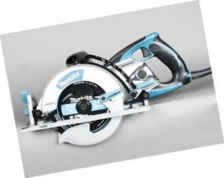

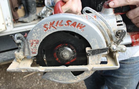

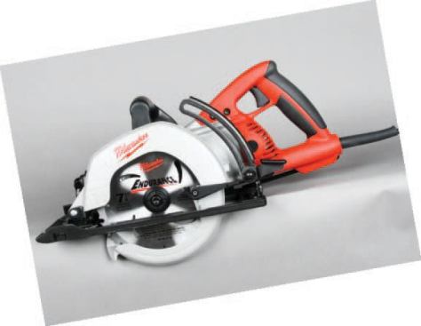

Fifteen years ago, when I started out as a framer, Skil was the only real choice for carpenters looking for an inline saw. Since then, a lot more companies have started making these tools, and now there are quite a few to choose from. For this article my crew and I tested six 7 1/4-inch inline models by using them on site in the normal course of our framing work: the Bosch 1677MD, the DeWalt DWS535, the Makita 5377MG, the Milwaukee 6477-20, the Ridgid R3210, and the Skil SHD77M. We evaluated them based on a variety of criteria, including power, features, and ease of use.

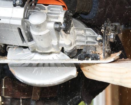

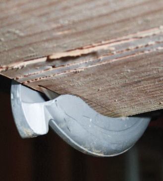

Many tradespeople have developed the unsafe habit of pinning back the guards on their saws or completely removing them. They do this because they don’t trust them to retract without snagging and stopping the saw. Guards are better than they were when I entered the trade, but some still snag – usually when you’re cutting compound angles or trimming a small amount off the end of a piece.

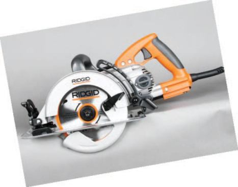

We experienced more snagging with the Makita and Milwaukee than with other saws. It didn’t happen often, but when it did, we found it very irritating. The guards on the DeWalt and Ridgid are the best of the bunch. They never hung up in use; we even tried to get them to snag and we couldn’t make it happen.

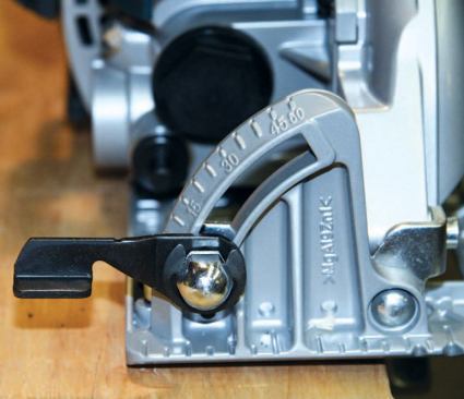

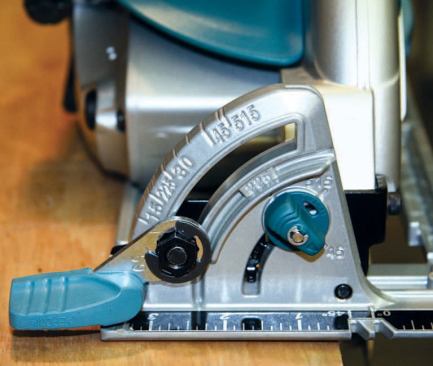

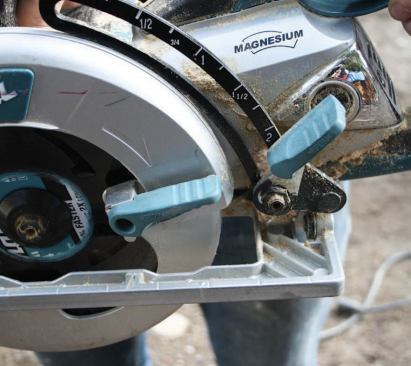

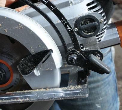

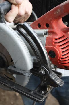

Bevel and depth mechanisms. The bevel mechanism is an important feature for us because we frame a lot of roofs and are always cutting bevels. The gauge should be easy to read, and the base should pivot smoothly when we’re adjusting it. It’s nice when there are stops at commonly used angles like 22.5 and 45 degrees.
It should be easy to change the depth-of-cut – the base should pivot smoothly when we release the lock lever. It drives me crazy if the depth-setting bracket binds when I slide it up and down, as often happens after a saw has taken a few falls.

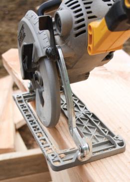

Rafter hook. When I put the saw down I want it to be within easy reach for the next time I need it, and the way to do that is by hanging it from a joist, rafter, or sawhorse. All of the saws have metal hooks that will fit over 1 3/4-inch LVL material; except for DeWalt’s, these hooks are all very similar. The one on the DeWalt is longer than the others and wide enough at the opening to fit over 2 1/2-inch I-joists. It becomes narrower farther in so that it will also fit properly on thinner material.

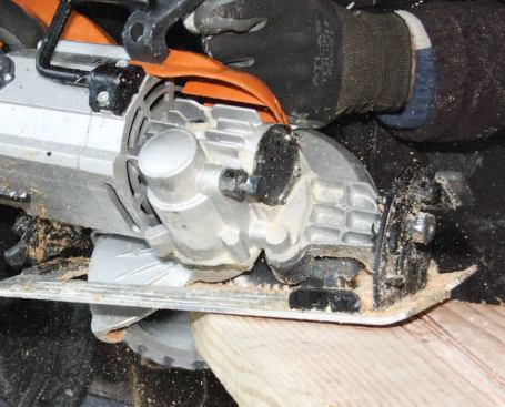

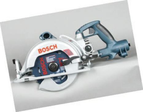

Other than the slide arm on the depth-setting mechanism, the most frequently damaged component of the saw is the base plate, which may bend if the tool falls. The best base plates are thick and heavily ribbed, like the ones on the Bosch, the DeWalt, the Makita, and the Milwaukee. The worst base plates are flat or nearly flat, like the one on the Ridgid. Skil’s plate, with its rolled edges, falls somewhere in between.

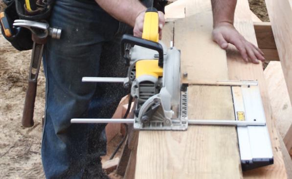

All of the saws can be used with an optional rip guide. In most cases, this is the same scrawny guide carpenters used 20 years back – essentially a bar that connects a 3- to 5-inch fence to the base. It works okay, but I don’t know anyone who uses it on a regular basis. The device is really more of a gauge than a guide; if you push too hard on the saw, it will pivot off the fence and the rip won’t be straight.
DeWalt developed a rip guide (DWS5100) that I actually like using. The fence, which will make up to a 14 1/2-inch rip, is about 19 inches long and connects to the saw with a pair of arms. It’s big enough that you can push the saw hard and cut quickly and still produce a very accurate rip. This is a fantastic accessory.

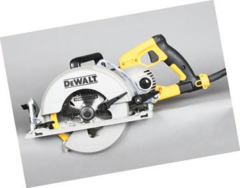

Nearly all of these saws are well-made and functional, but as someone who frames for a living I liked the DeWalt best. It’s powerful and rugged, and it has well-thought-out features, including an optional rip guide that actually works.

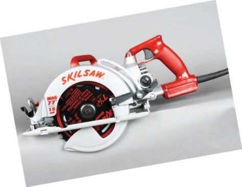

My second choice – despite its somewhat weak base plate – is the Ridgid. This saw is smooth-running, powerful, and equipped with a very nice guard. My third choice is the Skil. Compared with other models, it seems stripped down, but its upgraded guard and venerable reputation make it hard not to like. Tim Uhler is a lead framer for Pioneer Builders in Port Orchard, Wash. This article first appeared in Tools of the Trade magazine.
