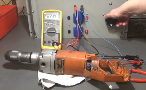

The video below was produced by a German guy who calls himself The Post Apocalyptic Inventor (PAI). I don’t know his real name but he appears to have an engineering/technical background—and he knows tools and how to repair them. Watch, and you’ll see him repair a Fein D-handle drill, a Bosch angle grinder, and a pair of unusual tools from Fein and Bosch—tapping drills specifically designed for threading metal. This video is not for everyone, but if you’re a gearhead, into tools, or like to fix things, then you’ll enjoy watching it.

02:12 You can tell this Fein D-handle drill is old because the housing is held together with slotted, rather than Phillips head screws.
02:20 It’s cool someone (the manufacturer?) thought to store a pair of replacement brushes inside the tool. Who, nowadays, even thinks that far ahead?
03:25 I had to look up what an isolation transformer is; now that I know I’m even more impressed with this guy.
04:40 It was a good idea to have opened the gear case, because he found metal shards that could have caused damage.
