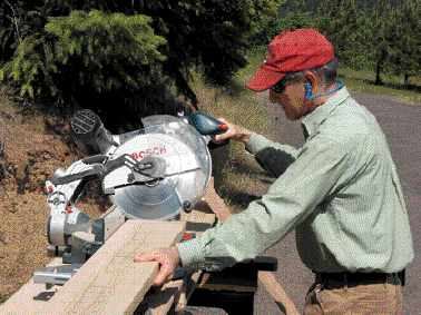

Two bevel features are noteworthy. The Bosch 4212L has a front-mounted bevel control that lets users lock and unlock the saw head and override the zero stop without reaching around the tool. And both Hitachi saws sport fine-adjustment knobs that make it easy to tweak the bevel angle without wrestling against the weight of the saw head.

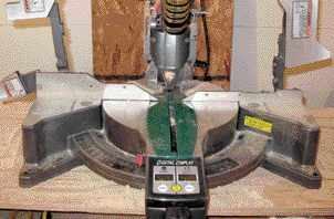

For cutting commonly produced crowns on the flat, all the saws include miter detents at 31.6 degrees, and all but the Hitachi and Makita tools include bevel stops at 33.9 degrees. (The Hitachi C12LDH does have a digital angle scale, though, so setting the precise bevel is not a problem; for more on this perk, keep reading).

To make way for bevel cuts, five of the saws use sliding fences, which shift horizontally after a knob or lever is loosened. My favorite of these gizmos is the Bosch 4212L fence; its tall, flat faces moved easily and provided exceptional support for the work.
