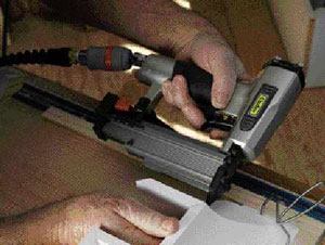

Pin-nailer safety devices differ from those on larger guns, and for good reason. Most guns have a safety plunger on the tip of the tool; unless the plunger is depressed the gun won’t fire. But plungers tend to mar fine finish work. Plus there are times when you don’t want to apply even the slight pressure required to depress a plunger — you just want to fire the nail, perhaps through a delicate molding return in perfect position.
That’s why most pin nailers have a double-trigger safety device — you have to pull the rear trigger before pulling the main trigger. On some of the guns, getting used to these two closely set triggers takes some time.
In fact, while firing the Nikle, you’ll find it’s almost impossible to use your index finger to pull the trigger, because there isn’t enough room between the magazine and the trigger. First it’s difficult to get a finger on the safety trigger, and then, if you can get all four fingers in there, you won’t be able to pull the trigger anyway because it bottoms out on your middle finger. We found it easiest to fire this gun with our middle fingers.
Double triggers with more separation between them were easier to use, like the ones on the Porter-Cable, Bostitch, and Cadex. Though the triggers on the Cadex, Grex, and Max are piggybacked, the design lets you use your index finger to fire the gun while holding back the safety with your second or third finger. Overall, once we had gotten used to the individual guns, none of them were problematic.
One word of warning: Just because the gun has a safety doesn’t mean you won’t fire a nail accidentally. Because of the trigger design, we all found ourselves picking up the tool and depressing the trigger simultaneously — which means we all carried the tool ready to fire.

The size and accuracy of the nose has been improved on the new pinners. Nearly every tool available has a needle point, which makes it much easier to get the nose and pin right where you want them. Not only can you see precisely where you’re placing the fastener, but you can tuck the sharp nose against a small filler or inside a tight quirk.
Several of the guns come equipped with soft tips, which protect your workpiece. I rarely had a chance to use them, but not because I didn’t want to. The Cadex, Grex, and Max come with two tips on each gun, one on the nose and one stored near the magazine, but the guys on my crew lost all but one in less than a month!
