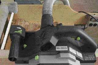

The Festool automatically cuts without snipe, thanks to the length of the sole and to the rear position of the tool’s handle.

The safety switch on the Festool is easy to reach while gripping the handle. The Porter-Cable has no safety switch. However, the location of the motor on the Porter-Cable provides some protection from the cutter — it’s the only portable power plane with the motor mounted on the side of the tool, beneath the elevation of the cutter blade.

Ingeniously, depth adjustment on the Festool is accomplished by twisting the front handle, just like on a motorcycle. A switch near the handle will lock the cutter at the desired depth, making it possible to change settings while planing.

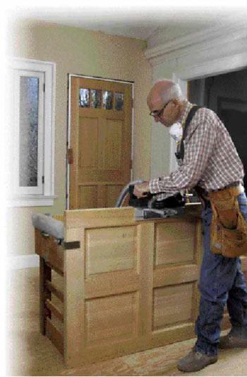

Dust collection may not always be required on new-construction sites, but it is always an issue when you’re working on owner-occupied remodeling sites. Dust control is also becoming more of a health issue, and catching dust at the source can help cut down on cleanup costs.
I’ve had clients complain even when I’m hanging doors in the driveway and the dust gets on the front lawn, not to mention on a freshly washed car or through an open door. On single-door jobs, cleanup can take as long as hanging the door, so having a reliable dust-control system is important.

The Festool’s dust-control system is even better: The large ports never clog, and they can be switched to operate in either direction. The large bag collects nearly all the dust. When you use a tool-triggered vacuum, the Festool doesn’t leave a speck of dust behind.

Planer cords will snag on the end of a door or a door bench, which pulls on the planer, interferes with the cutting action, and, in some cases, produces a divot. Both the Festool and the Bosch suffer from this problem, while the Porter-Cable planer has a very clever knob on the back that guides the cord to the outside of the door, so it never snags.
Cord length is also important: The longer, the better. Bosch’s cord is 8 feet long, Porter-Cable’s is 10, and Festool’s is 13. (If your cord is snagging, try taping a short length of coat hanger to it, right at the back of the handle, so you can control how it drapes.)
