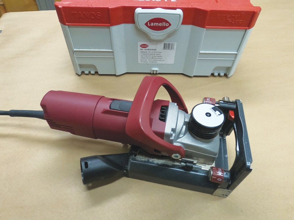

Then last year, I discovered the Lamello Zeta P2, the great-great-grandchild of the original biscuit joiner, which was invented by a Swiss engineer and amateur cabinetmaker named Herman Steiner in 1956. In 1968, Steiner built the first portable biscuit joiner, called the Lamello, and variants of this design are now manufactured by many tool companies.
The Lamello Zeta P2 features a unique vertical mechanical drive on the cutting spindle that creates a profiled groove. This function can be deactivated for standard biscuit installation. A 7-mm carbide-tipped cutter is used to cut the grooves needed for P-System connectors. For installation of wooden biscuits, the 7-mm cutter can be replaced with a 4-mm groove cutter.
The new Lamello—the Zeta P2—is a biscuit joiner on steroids. What makes it so special is its ability to oscillate and cut a kerf at the end of the plunge cut. This kerf allows the user to slide in half of a mechanical “biscuit” made of plastic in one of several configurations. When you join the two mating sides of a P-System biscuit together, you get alignment and a built-in clamp as well.

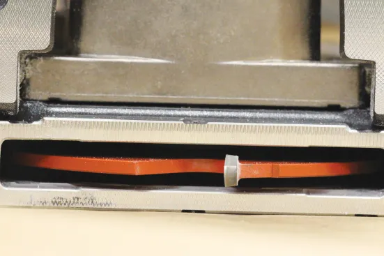

The Zeta P2 leaves a profiled groove that fits a series of special mechanical plastic biscuits.

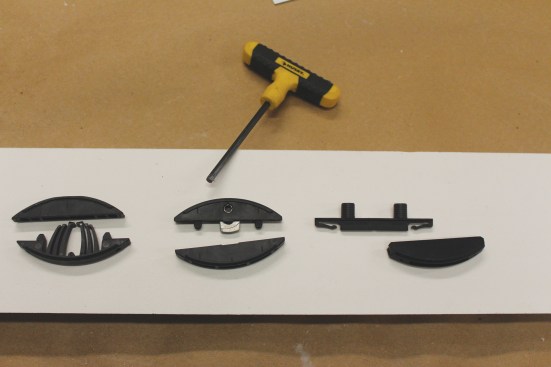

Available connectors for the P-System include (left to right) the self-clamping Tenso, the Clamex detachable furniture connector, and the Divario sliding connector for shelving.

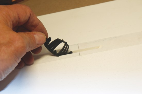

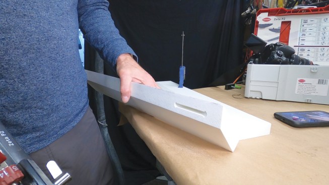

One connector, called the Tenso, is self-clamping, an incredibly useful feature when I’m working with exterior PVC trim. With the Tenso connector, I find it easy to align and clamp butt joints, miter joints, and compound miter joints with incredible precision; not having to nail or screw pieces together results in cleaner looks and almost one-handed assembly in the field. It allows me to field fit a joint and make sure it looks good before committing to the final glue-up.
Shown here is the Tenso P-System connector, which is inserted by hand into the T-shaped slot.

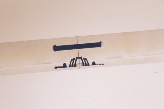

When the Tenso joint is assembled, the two parts are locked together without glue or screws.
For example, when fitting 90-degree outside corners with PVC trim, I typically would hand-align the outside miter after applying PVC glue, then pin the joint together. Now, it’s literally a “snap.” Any angle joinery can be quickly conquered by the versatile options for setup.

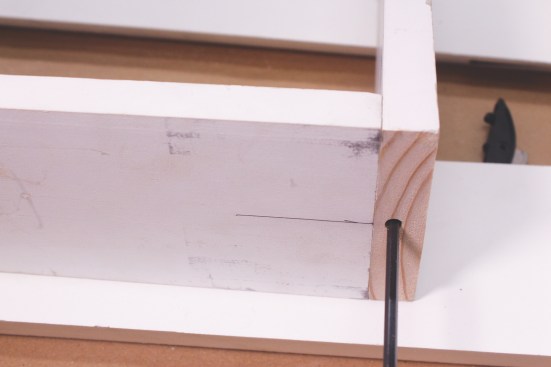

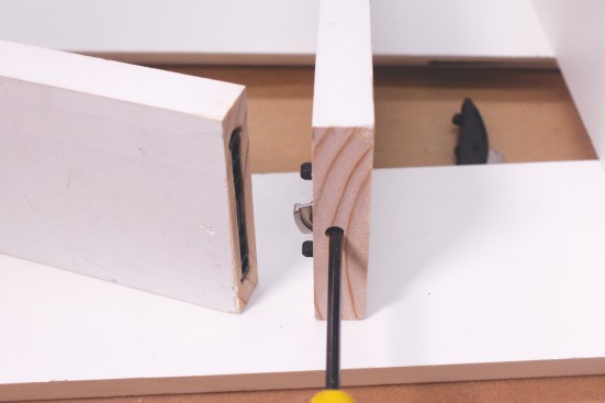

For cabinetmakers who need a knock-down assembly, the Clamex is a clamped, two-part mechanical joint that’s assembled and disassembled with a small Allen key. It comes in different sizes for different applications.
Available in a couple of sizes, the Clamex connector has a lever that is operated with a hex key, which allows the joint to be disassembled if desired.
Access for the hex key to the lever mechanism that engages the Clamex connector is through a small, 6-mm hole.

I initially envisioned that this tool would find a home in a cabinetmaker’s shop, where it would be used for joining fine trim and cabinetry. However, once I brought the Zeta P2 to the jobsite, I found all sorts of uses for it, including outside trim. That’s partly because the Zeta P2 offers the ability to change the blade to a standard biscuit blade and use it as a traditional joiner.
The Zeta P2 is well-built, and the versatility of the available attachments, such as positioning pins, spacers, and a stop square, makes for precise placement of joinery. The only negative thing I can say about it is the learning curve. It took me a while to figure out how to set it up for the various applications. The instruction book is a generic, multilanguage, illustrated paperback, but once I discovered the videos on the company’s website (csaw.com/lamello), I buried the manual in the bottom of the Systainer it came in. If you are into high-end trim and cabinetry work, this is a solid investment ($1,550) you won’t regret.
