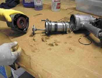

Some disassembly required. I work on a large, clean piece of cardboard that gives me space to spread out parts; when I’m done I can throw the mess away. With the diagram nearby for reference, I start taking the tool apart by removing the cap screws. Some tools have spring-valve assemblies under compression beneath the cap, so I back the screws out evenly to avoid jamming.
Sometimes the cylinder and piston are beneath metal or plastic disks that snap into place, but usually the cap is all that needs to be removed to see these parts. When there’s a nut on top of the piston, I use a pair of needle-nose pliers to grip it and pull the piston out (Figure 6). If the top of the piston is flat, I insert a thin metal rod up the nose to push the driver and piston out.
Because air flows between the cylinder and the body, a lot of dirt collects there. So, for a complete cleaning, I remove the cylinder in addition to the piston. Cylinders are held in place with two or three O-rings between the base or sides of the cylinder and the body of the tool, and they snap in tightly; getting them in and out takes some effort.
