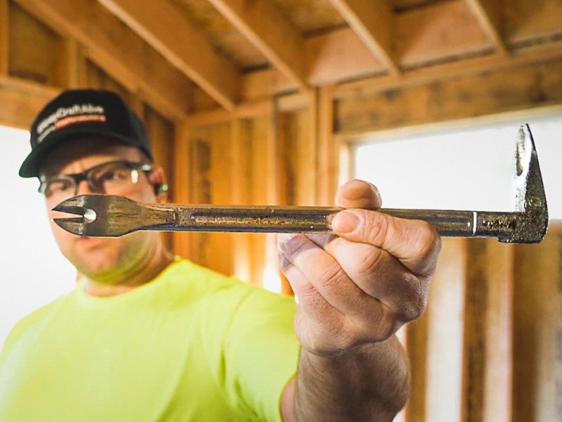

The Shark nail puller was a big step forward. It gouged less and got under the nail head better. This was our go-to nail puller until a couple of years ago. I don’t know why, but I went through quite a few of these in the last few years. I think the quality of the steel went down, and I broke three of them in one year. In all cases, the claw broke.
My co-worker tried out the Dalluge 12-inch bar from our local lumberyard. I kept trying other brands and didn’t like them. He loves that Dalluge and kept telling me to buy one and stop borrowing his all the time. What makes this bar so great is that the claw isn’t too deep and the shape of the V gets under the head of the nail and grabs without gouging too much. I highly recommend this bar. It isn’t expensive, and it does the job better than any bar I’ve ever used.

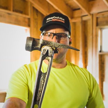

Now, in addition to this nail puller, I highly recommend the Martinez M1 titanium hammer. In 2002, I started using the Stiletto Tibone hammer and have been a convert every since. I’ve been swinging the M1 for more than three years and will not swing another hammer. One of the major benefits of this hammer is the metal handle and the side nail puller on the hammer. This allows me to use leverage and reduce the amount of effort I need to put into pulling nails.
