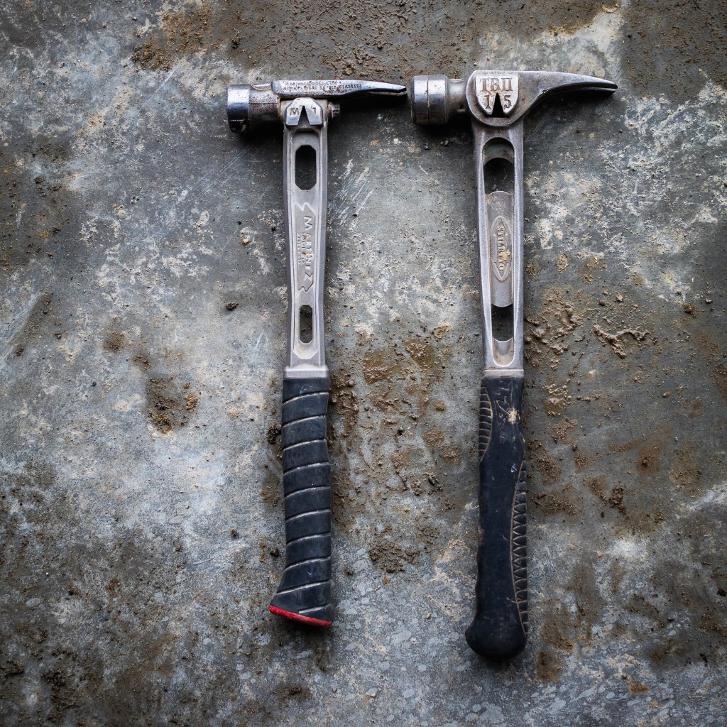

The Martinez M1, left, is slightly smaller than the Stiletto TiBone, right. The M1 comprises an all-titanium handle, replaceable steel head, and replaceable grip. The TiBone is all titanium with a replaceable steel face. The head on the M1 is slightly heavier than the TiBone's, and the smaller size keeps it at 15 oz.

Back in December, Mark Martinez, the original inventor of the Stiletto TiBone hammer, called me up to introduce his newest invention: the Martinez Tools M1 Titanium handle hammer. I have been using a Stiletto TiBone since 2002, and so was eager to try a new hammer design that allegedly overcomes some of the design issues with the TiBone.

Let me start with some backstory on the TiBone, because the M1 can’t be fully appreciated without this context. The TiBone is an all-titanium hammer with a replaceable steel face. I have been recommending the TiBone for years, despite some of its flaws. Stiletto’s warranty states very clearly that its titanium hammers should not be used to strike hardened-steel like cat’s paws—presumably because it will smooth a milled face. I have always ignored this because I personally don’t care if the milled face of my hammer becomes smooth over time.
Another issue common to the TiBone is that the face will twist and the nail slot will stop lining up, which is exactly what’s happened to all but one of the hammers on my crew over the years. As a frame of reference, I’d say we’ve had 10 of these hammers over the years on the crew. And because of hitting my cat’s paw, the magnet fell out. While I love the nail slot, I don’t care that the face has twisted or that the magnet fell out.
Another issue is that the grip will wear out eventually. When this happens, I send my hammer in to Stiletto and they replace it with a hammer that has similar wear, but a new grip. That has always been good enough for me.

The M1 has a titanium handle and a replaceable steel head. After using the M1 for the past several months, I have to say that it addresses each of the “cons” I listed above about the TiBone. To stay well-balanced, the hammer is slightly shorter than the TiBone—which took some getting used to at first, but, once I did, I found I actually preferred it. And what’s the advantage of the M1’s steel head? Well, it can easily be replaced for about $50. You could actually buy the hammer with a milled face and buy a smooth face if you need one and not have to buy two hammers. The one-piece steel head also means the nail slot will always work. The nail slot is large enough for a duplex nail head—something that didn't matter much to me, but is an example of the amount of thought that went into the hammer's development.

Verdict. I absolutely recommend the M1 over the TiBone. It did take about a month to get used to it being a little shorter, but after that month and going back to the TiBone, the TiBone felt too long. This just tells me the length of either is fine—you can get used to whichever you're using. But I did prefer the shorter hammer in the end.
The reasons I prefer the M1 come down to the way the head is attached, the grip, and that I don’t have to buy a new hammer if the head either breaks or is too worn or the grip wears out.
