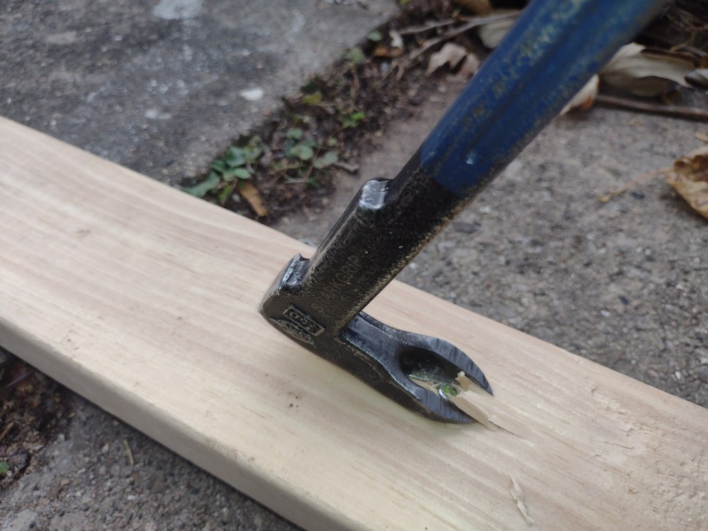

The "v" of the nail puller grabs the nail's shank, not it's brittle head.
Much of the tool’s utility comes from its shape. The sharp teeth and flat grind on the inside of the paw dig into wood with ease, and the tapered notch grips a slightly proud nail without needing to be set with a hammer. In addition, the acute angle on the notch lets the tool pull an entire spectrum of fasteners, from 18-gauge finish nails to 4-inch spikes. Finally, the curve along the head of the tool enables a smooth, easy pulling motion. All these details add up to suit the tool for a wide range of situations.

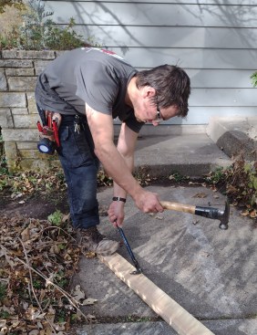

Set, hit, pull, repeat speeds up the task. And the comfort of knowing my fingers are good and clear, far away from where the hammer hits the tool, lets me hit with force. Although, the Shark’s shape means the weight of a falling hammer alone is often enough to capture a nail.
With the set, hit, pull rhythm, I can pull nails out of a subfloor with speed and ease. I pulled a few hundred nails the other day, and I could barely count on two hands the number that needed another tap or pull. At around $25, this tool is a must-have. sharkcorp.com
