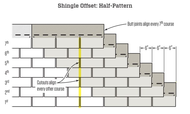

A staggered pattern – one in which each course of shingles steps over a given distance from the course below – can provide better protection for the roof. The most common of these staggered patterns is half-tab, where the tabs align every other course and the butt joints align every seven courses, reducing the chances that wind-blown rain can find its way through.
A half pattern (also called half-tab or sixes) staggers each course with a 6-in. offset (half a tab width for metric shingles). Butt joints are better protected from water migrating horizontally, but cutouts still align every other course.
Tim Healey

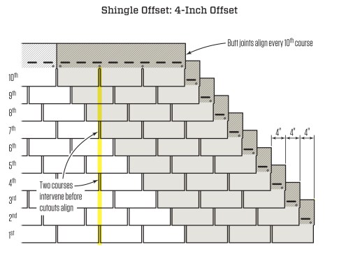

A 4-in. offset keeps cutouts separated by two courses, and butt joints align every ten courses. But the short lap doesn’t provide enough protection in wet climates, or in areas with severe freeze-thaw cycles.
Tim Healey

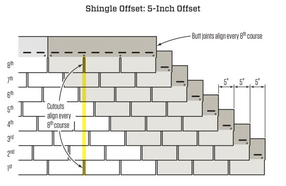

Here, the courses are offset by 5 inches between courses. The pattern looks more random from the ground, and helps hide shingle irregularities. The cutouts align only every eight courses, so runoff is less likely to cut channels into the shingle granules. Butt joints also align every eight courses, providing good protection from wind-blown rain.
Tim Healey

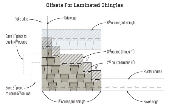

Architectural-style shingles should be staggered according to the manufacturer’s recommendations that come with each bundle. Following those instructions ensures that the laminated tabs of shingles in successive courses don’t align. Typically, the instructions have you remove a certain specific width of shingle for successive courses. Unlike the three-tab shingles, the architectural-shingle courses don’t stagger evenly, but with the manufacturer’s directions, the sections that are cut off can be used to start courses above in the sequence.
The installation pattern for laminated, or architectural-style, shingles is determined by the manufacturer to prevent the tabs or cutouts in the shingles from aligning course to course. The cutoffs are designed to be used as starter shingles for courses farther up the roof. In this example, the 6-inch and 11-inch cutoffs are used to start the fourth and fifth courses. With this strategy, the butt joints align every six courses.

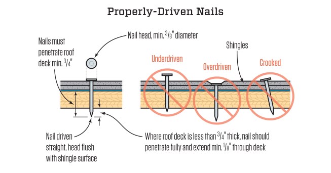

Nailing. Driving the nails that hold a shingle on the roof is one of the first things to practice and get right. Start by selecting nails that have a head at least 3/8 inch wide and that are long enough to penetrate 3/4 inch into the roof deck. (Most manufacturers will specify a minimum-length nail, so read that shingle wrapper.)
Drive the nails so that the head is flush with the shingle surface (see Properly Driven Nails, below). Nailing depth is especially critical when you are using a pneumatic nailer, which can drive roofing nails at different depths depending on how solid the material is below the shingle. Adjust the pneumatic nailer’s air pressure to drive the nails flush with the shingle surface when nailing into the sheathing between rafters. As you work the gun, keep an eye on the depth of the nails. When a nail hits framing, it might not penetrate deeply enough, and you will need to drive it flush to the shingle surface by hand. But if the nailer is adjusted for driving nails into the framing, then there may be a tendency to overdrive the nails. Underdriven nails can be finished by hand, but overdriven nails can damage the shingle and have to be pulled out.
Nails for attaching shingles need to have a head at least 3/8 inch in diameter. Drive nails so that the head is flush with the surface of the shingles. Underdriven nails will not anchor the shingles properly and can damage the overlapping shingles; overdriven nails damage the surface of the shingle; and crooked nails break the surface of the shingle and can damage the overlapping shingle as well.
Tim Healey
When nails are underdriven, they are left with the head sticking up above the surface. This scenario leaves the shingle unsecured and able to move on the shaft of the nail. Underdriven nails are also apt to damage the overlapping shingle over time.
When nails are overdriven, they break the structure of the shingle. This can lead to a blow-off, or a shingle that slips down the roof. A shingle nail driven at an angle does not secure the shingle evenly and damage to the shingle is inevitable.

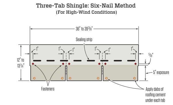

In high-wind areas, drive two nails above each cutout as well as nails at both ends of the shingle. Manufacturers may also recommend dabs of roof cement under the tabs to help adhere the tabs in place.
Tim Healey

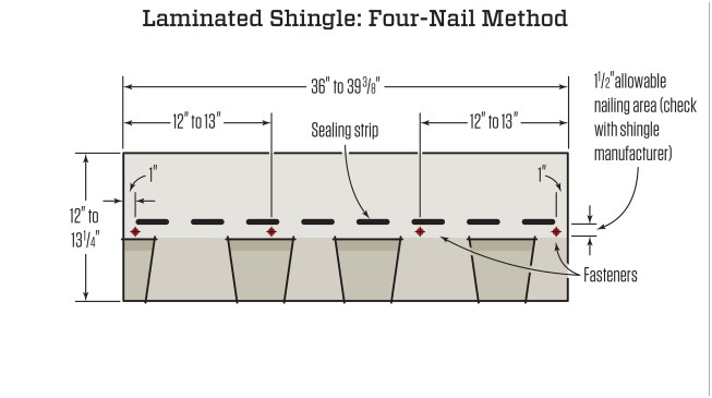

When installing laminated (architectural) shingles in normal areas, drive nails 1/3 and 2/3 of the way across each shingle, and at the ends.
Tim Healey

Cutting Shingles
When cutting shingles, always cut from the back. Rarely do the shingle courses end precisely on the half-tab distance. Don’t just let the shingles hang over the rake and then trim them all at once at the end. This can result in a ragged edge along the rake while creating a lot of waste, as usable parts of shingles fall to the ground.
A better strategy that doesn’t require a lot more time is to cut shingles individually to complete each course. You don’t need to measure this distance and transfer it to the shingle. Just set the shingle (or usable scrap) in line to the rake, and make a nick with a razor knife at the top edge of the shingle. Then flip the shingle over to make the cut.
