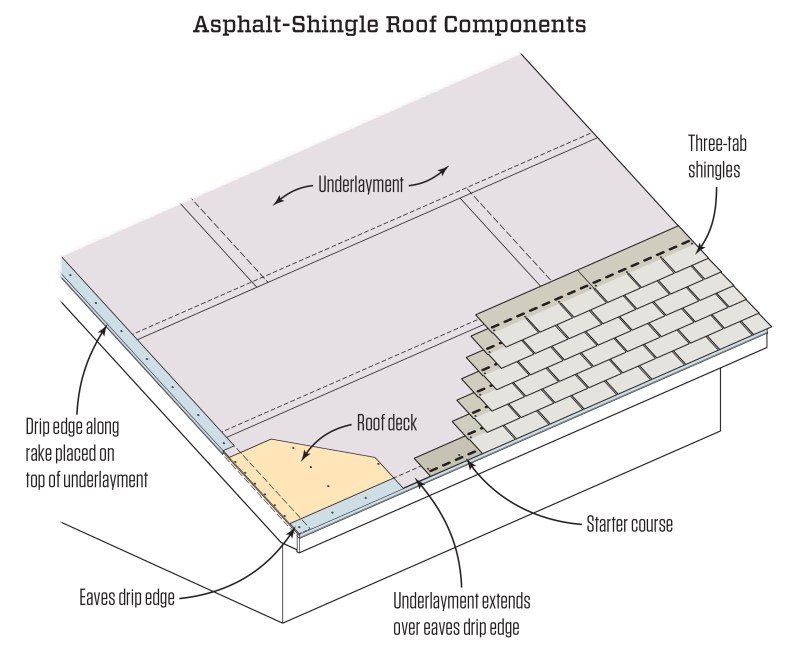

This isometric illustration shows the different layers of a typical asphalt shingle roof. The roof sheathing is covered with underlayment, usually tar paper or peel-and-stick membrane. Drip edge is applied along the eaves and rake edges. A row of starter shingles goes on along the bottom edge, with the shingle courses applied over that. Note that manufacturer's instructions should be consulted before installation to highlight any differences in the process.

  • Three-tab shingle: Roof shingle that consists of a single layer of asphalt where the exposed part of the shingle is broken into three parts or tabs via slots cut into the shingle.
  • Architectural shingle: Roof shingle made from multiple layers of asphalt laminated together to give the shingle a more dimensional look.
  • Eaves edge: Lower edge of the roof where it meets the fascia.
  • Rake edge: Gable edge of the roof extending from the eaves to the peak.
  • Starter course: First course of shingles installed along the drip edge at the eaves below the first exposed course of shingles. Starter-course shingles are often a regular shingle with the exposed portion removed.
  • Underlayment: Asphalt-impregnated felt paper or peel-and-stick membrane applied over the sheathing before the shingles go on.
  • Drip edge: Metal edging attached along the eaves edge and rake edges to help weather seal the shingles.
  • Roofing cement: Thick material that is used as an adhesive and to seal between layers of shingles.

Asphalt shingles come in two basic configurations: three-tab and architectural (or “laminated”) shingles. Three-tab shingles are made from one flat layer of asphalt with slits (called “cutouts”) that create three tabs on the exposed portion of the shingle. Architectural shingles are made from multiple layers of asphalt laminated together to give them a more dimensional look. Installation for the two shingle styles is similar, but always review the manufacturer’s instructions on the shingle wrapper in case its recommendations vary from the standard procedure outlined here.
Both shingle styles have an asphalt sealing strip, and nails should always be kept below this strip for the shingles to seal properly. The allowable nailing area is a fairly narrow band between the top of the tabs and the sealing strip. Place nails as shown in the illustrations. Drive nails above each cutout as well as 1 inch in from the ends. In high-wind areas, extra nailing is required; refer to the JLC Field Guide.
