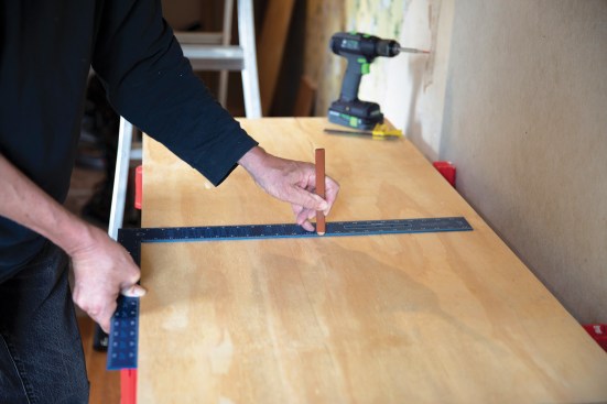

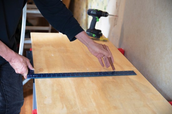

Step 1. Hook the tongue (short leg) of the square along the side of a piece of dead-straight stock. (Alternatively, you can butt the tongue to a straightedge, but clamp the straightedge down so it doesn’t move.) Draw a line along the inside of the blade.

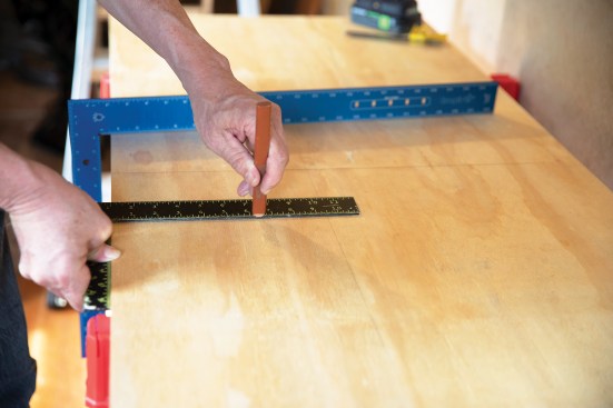

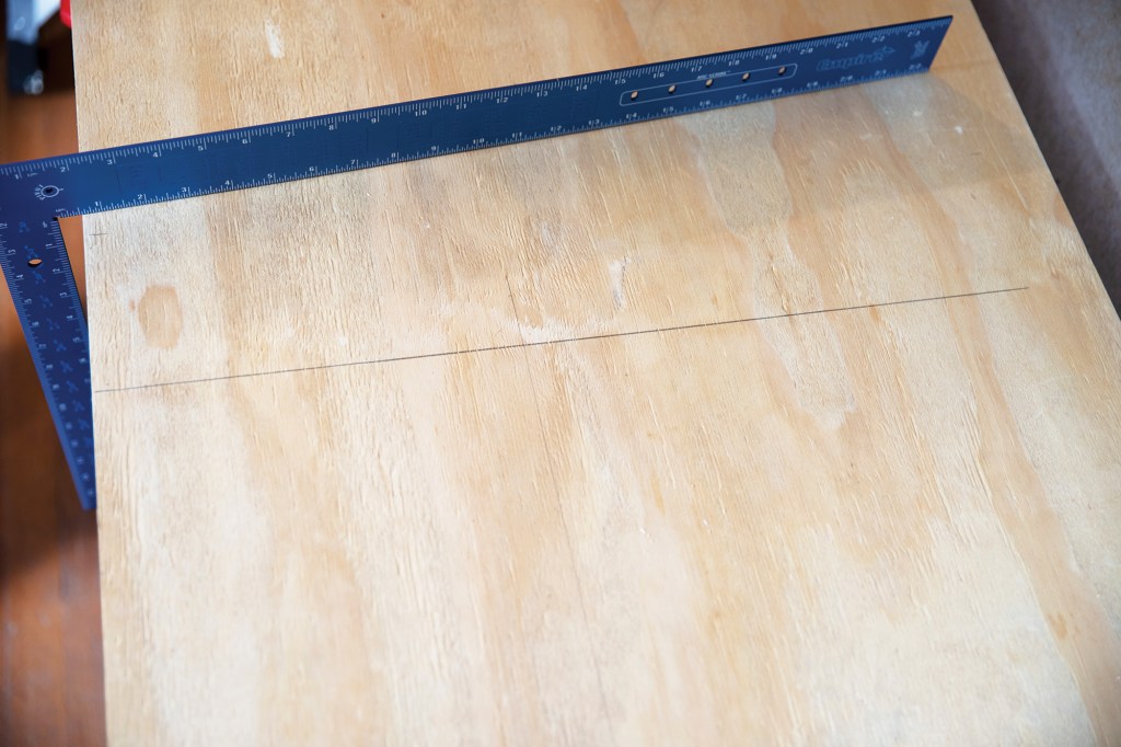

Step 2. Flip the square so the tongue points the opposite direction. Line the base of the blade up with the line you just drew and draw another line along the same side of the blade.
Note: If you can find a straight edge on a store display and draw two tick marks (one at the base of the blade on the display edge and one near the end of the square’s blade on a box on the shelf below), you can perform this check right in the store before you buy a square. I was shocked that a whole rack of the more expensive “red” squares at a big box store were out of square, some by quite a lot. There were a few good ones among the less expensive “blue” squares.
Here the author is checking a smaller square following the steps outlined above (see Steps #1 and #2).
After marking the first line (left photo), the author flips the square over and marks the second line (above).

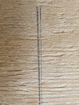

A framing or carpenter's square is not actually square when two lines marked as described above diverge, as shown here.

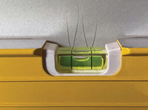

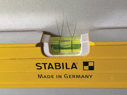

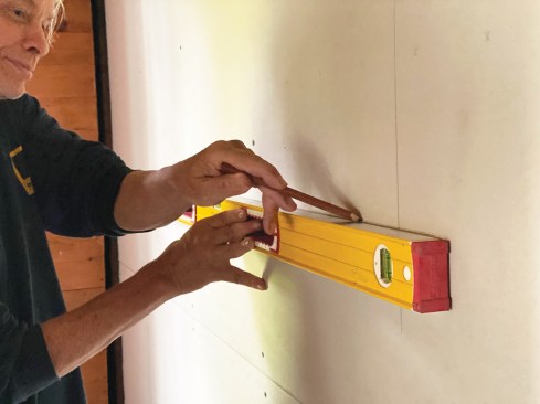

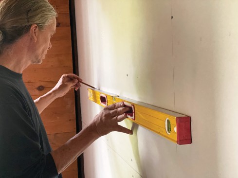

Step 1: Hold the level flat against a wall, and adjust the tool until the bubble on the vial is centered between the two lines, reading “level.” Mark the location of the vial on the wall. You can make one mark in the center of the bubble, but I usually make a mark at each line on the vial so I can reposition it easily.
Step 2: Draw a level line along the length of the level on the wall, as shown.
Note: You can just mark the wall at the far ends; you don’t need a continuous line.
Step 3: Flip the level end for end, keeping the same edge of the level facing up. Line up the vial in the same location using the reference marks, and adjust the level so the vial reads level again. You should see that the level is aligned on the level line. If it’s not, draw a new line (or make new marks) to judge how far off it is.

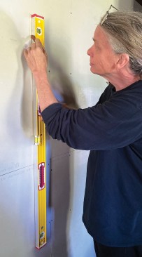

Plumb check. Next, hold the level plumb and align the tool so that one vial reads plumb, then follow the steps as shown below.

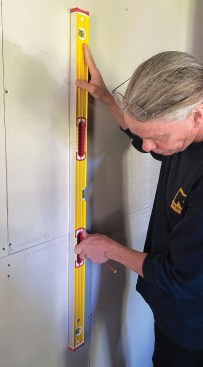

Step 4: Hold the level plumb and align the tool so that one vial reads plumb. Now look at the other vial: Both vials should read true. Draw a plumb line (or make marks on the wall at each end of the tool).
Step 5: Keeping the tool vertical, turn it over so you have the same vial at the top end. The opposite face of the level will be facing out, and you should now be referencing the opposite edge of the tool. Align the tool on your plumb marks and check both vials. They should both read plumb.
