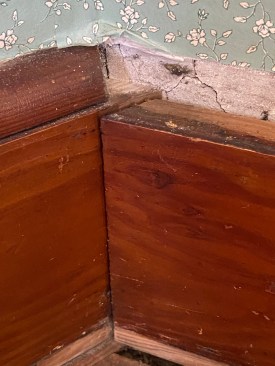

Reverse order. A big part of removing woodwork is knowing how it was assembled in the first place. You need to remove it in the reverse order it was installed. Nothing here will suffice for experience in knowing how to trim a room.
Either side of a mitered base cap can be removed first, but the baseboard itself is different. The overlapping piece on the right dictates starting on that side.

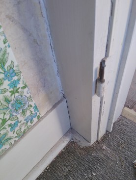

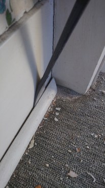

Before the door casing can be removed, the carpet mold and baseboard need to come off.
Look at the joints first. Miters can usually be taken apart from either side. Look at both ends of each piece of trim before you act. The ends of baseboard that butt each other in the corners have to be taken apart in order: overlapping piece first. With crown molding or other moldings that have been coped at corners, it’s often hard to decipher which piece was installed first. You may have to skip ahead to the next principle: “Loosen up everything” (below). Once the seams are loose and you have gaps, you can see which piece overlaps the other.
It’s a lot easier to determine the installation order of clear-finished woodwork than that of painted woodwork. Think in layers. Peel off the cap trims first. This will often reveal how corner joints were put together.

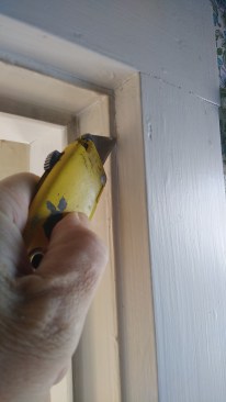

The first step is to use a utility knife to slice through paint or varnish along seams to break the bond of the finish. (Don’t underestimate the strength of a finish. Varnish is especially tenacious and can sometimes pull apart wood grain, destroying the crisp edges that will be instrumental when you put the work back together.) Slicing through the finish will allow you to remove the more delicate cap trims, back bands, cove molds and other decorative bands on built-up moldings.

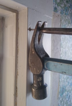

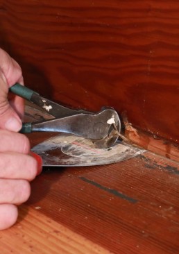

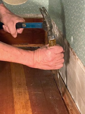

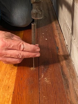

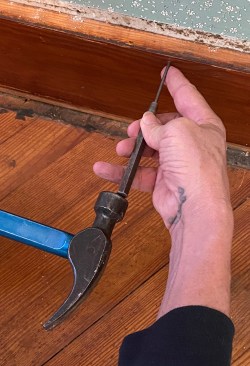

To loosen trim, disable finish nails by driving them clear through the wood with a pin punch. (I use one from Baltimore Tool Works that has served remarkably for years without mushrooming at the end. Mayhew acquired Baltimore Tool Works and the Mayhew 21500 is good alternative.) You may not get all the nails in a run, but the more nails you disable, the less hold the board will have.

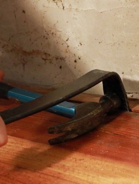

When you need to preserve a board, you can't mar the face with a catspaw. Instead of pulling nails, use an 1/8-inch pin punch to drive finish nails through the back of the board. When the punch has been driven deep, it's sometimes hard to pull back out, but you can pry it out with the claw of a hammer.
Often it just needs to be loosened, after which it can be pulled out by hand.  If the nail is small enough, though, you will be driving the pin through fresh wood and it will need to be pried all the way out. In this case, use a block under the hammer to keep from bending the pin and to protect the face of the board.

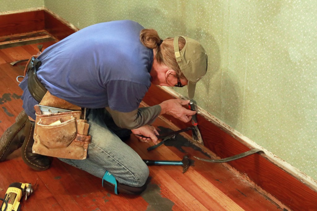

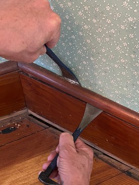

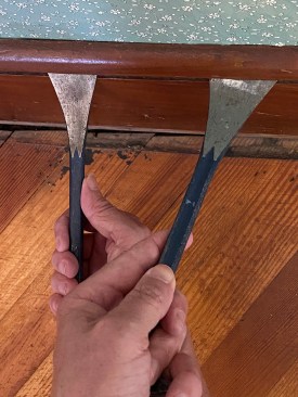

After breaking the hold of the finish, begin to pry things apart. Go slow. Think at first of just loosening the parts, not ripping pieces off. I like to work with two pry bars in tandem.
Wide-chisel pry bars have a thin, sharp blade that does minimal damage to soft woods.
Use two in tandem, overlapping as you work along the entire length of the board.
I like the Japanese wide-blade pry bars by Yamaguchi (shown in this article; I can no longer find a U.S. source), Dogyu, or Shark Corp. The wide blade on these is quite sharp (and can be tuned up with a file) to slip into the seams between trim pieces without denting the wood. Stanley and Stilletto also have wide-blade molding bars, but the blades aren’t as fine … Both can be ground to a sharper blade, which I would recommend. The Stanley is a good choice if you don’t mind grinding the blade, as it’s the most reasonably priced of all (around $13 for the 10-inch model). The Stilletto is completely the opposite: way overpriced (around $68 for an 8 1/2-inch model), especially for a tool you have to modify for fine finish work.

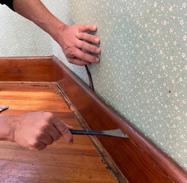

The wide blade on a Japanese pry bar is bent at the end so you can get plenty of leverage. Be sure to insert the blade first, and tap the bar with a hammer to drive the blade into the seam between the molding pieces, then gently leverage up.
Pry close to each nail so the force of the pry bar is transferred directly to the fastener. If you pry between fasteners, you often will only bend the molding, which will stay pinned by the nails, and you risk breaking the molding.
When using any pry bar, be sure to pry against walls at studs to avoid punching through wall surfaces.

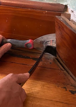

Avoid prying against finished boards, but when you can’t, use a wide, flat trowel under the fulcrum point of your pry bar to protect the finish surface. As the board becomes looser, it will be easier to identify fasteners that are still holding a piece in place.

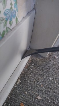

With painted woodwork, it’s often more difficult to find the nails. But if you break the paint-hold at the seams and work the pry bars to loosen the boards just a little, the nails will usually reveal themselves.
Break the finish bond at seams with a utility knife. This is a good first step with any finished woodwork, but it's a must for heavily painted trim.
Gently pry at the seam, just enough to loosen any nearby nails. When you relax pressure on the prybar, the extended nail will push out the small plug of filler, revealing the nail's location.

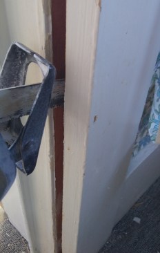

The goal is to remove trim without excessively bending the trim pieces. We tend to think in terms of using pry bars to pull material apart, but when you want to preserve the materials, it’s all about disabling fasteners.
Driving nails through the board is not the only option. Cutting the fastener is a faster option if you have a gap to slip a recip saw or multitool blade into.

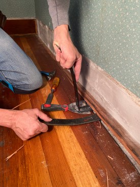

Floors are a different animal than trimwork, but many of the same principles apply.
Think in terms of how the floor was laid and reverse that. Strip flooring is joined with a tongue-and-groove joint. When it was installed the first time, it was “blind nailed” with nails through the tongue side of each board. But the last few boards are too close to the wall to allow angling the nail to drive it through the tongue, so these last few boards are usually face-nailed. You need to identify and disable those nails to begin disassembly.
Installers face-nailed the last floor boards. This is the side to start with.
The last board installed will be the first board to come out, but it’s often hard to get it out intact. Once the fasteners are disabled, try to loosen the board by driving it away from the tongue on the next board, as shown below.
To loosen up a floor board, the author drives a flat bar into the gap and pushes it away from the tongue on the next board. Note that you can strike the bar in the "opposite" direction to push the boards apart.
There wasn't enough space along the whole length of the wall between the last board and the wall to clear the tongue, so the author had to split off the tongue with a chisel.
Depending on the gap between the last board and the wall, you may not have enough space to clear the tongue. That was the case I faced on this project, and I had to sacrifice the tongue, splitting it off with a chisel. After that, I was able to pry the board out.
Once the tongue was split off, the last board could be pried free. Note that the author is using a wide trowel to spread the load of the flat bar in his left hand to prevent denting the floor surface. This is the bar he is using to exert the most force on to pry the board loose. The flat bar in his right hand is just holding the board up as he works along the length of the board, using the two flat bars in tandem.
