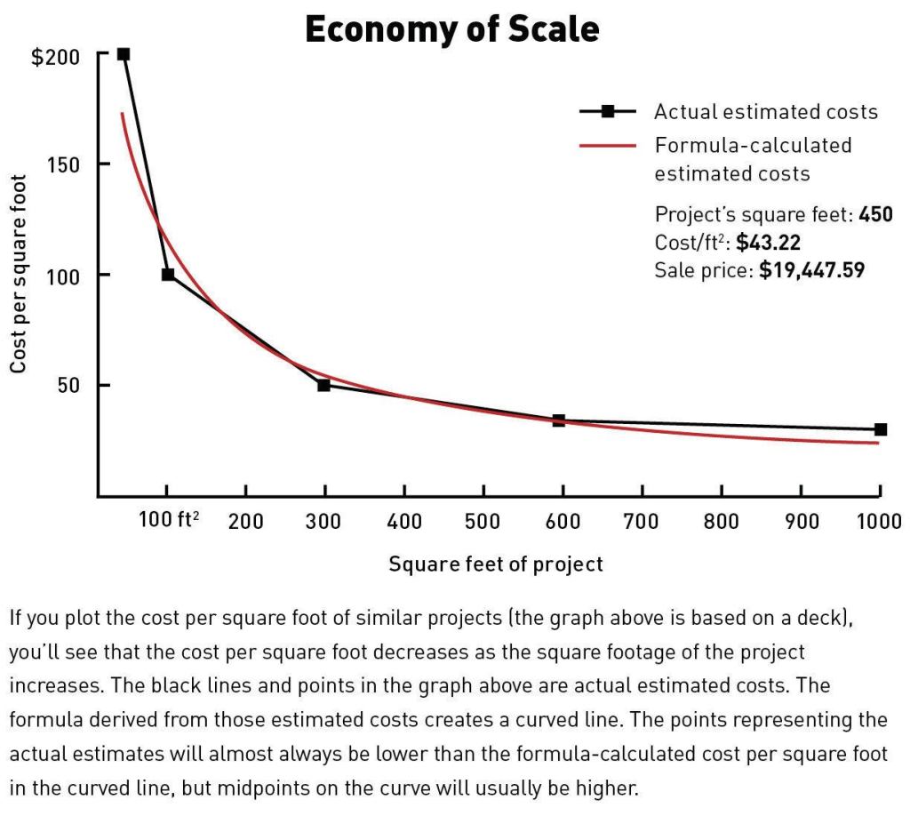

To gain a better understanding of why my assembly estimates did not have a similar cost per square foot, I used the same assembly to estimate prices for five decks where area (50, 100, 300, 600, and 1,000 square feet) and railing length were the main variables.
I divided each price by the square footage of the corresponding project to calculate a price per square foot, then plotted the results for all five on a simple size vs. price chart. I expected the line to descend, but the big surprise was that the plotted line was not a straight line; it was in fact a curve, as shown in the graph at left. (The two lines in the figure are slightly different; the formula creates a curve, whereas the straight lines connecting the plotted points are like steps that the curve smooths out.)
Research showed me that this curve effect, or so-called “efficiency curve,” is common in many endeavors of a repetitive nature and is the driving force behind an economy of scale. This curve is the fundamental result of learning and repetition, where the time it takes to do a task falls off quickly at first but eventually levels off at the point where the task is being performed to its highest efficiency.

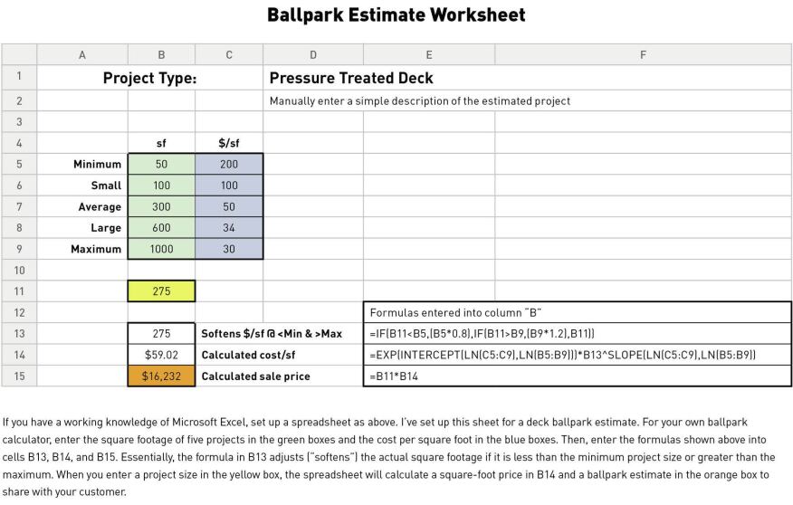

Setting up your BallPark Calculator
To set up your own calculator, you need to know enough about Microsoft Excel to input data and formulas in a few fields in the program, but first you need to do the following:
1. Do five estimates, using your own tried and proven system, of various square-foot sizes of the same project type. I used a pressure-treated deck as an example here, but you can use any type of project you wish, as long as it’s an area-dependent one—such as an addition or deck—and not a material-dependent project, like a kitchen or bath.
Your estimates should include the smallest and largest sizes that you would build and three intermediate sizes spaced out somewhat incrementally, as in my deck example.
When doing your estimates, keep the specifications the same. Adjust only the quantities of piers, beams, ledgers, joists, decking, railings, stairs, and the like, and the miscellaneous job costs, such as mobilization, protection, hauling debris, portable toilets, project management, and cleanup.
2. Divide your five estimated sale prices by the corresponding square footage to obtain a dollar-per-square-foot cost ($/sf) for each project.
3. Open a new MS Excel spreadsheet and set it up exactly like the one shown below, using the same cells and the same formulas that are listed under “Formulas entered into column ‘B.'”
4. Once you have set up the spreadsheet, you can use it to accurately calculate your budgets for any size project by simply entering the square footage in yellow cell B11.
